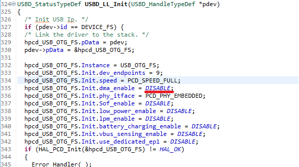

I am working with STM32H743ZI
When I enable USB DMA, writing enable here :
I have 3 bytes of offset in my frames, my frame is supposed to start with aa:55:dd:aa instead of 00:00:00:aa:55:dd:aaIt is fixed when I disable DMA but I want to use it

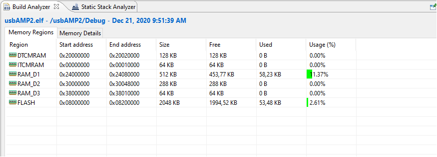

Here is my memory usage :
Any parameter I am missing ?

Hi Gabriel,
Can you please disable the cache when using USB DMA.
Please use a non cacheable memory region.
Best Regards,
Ons.
‎2021-01-04 4:26 AM
If I get it right, I should put buffers used by USB in DTCM RAM but will the USB DMA be able to access it ?
Regards,
Gabriel
‎2021-01-06 7:13 AM
Hi Gabriel,
No, for H7 devices DTCM could not be accessed when enabling DMA USB.
Please refer to this FAQ, it should be helpful. It is wrote for the use of DMA peripheral in STM32H7 devices, but this is applicable when using DMA for USB too.
