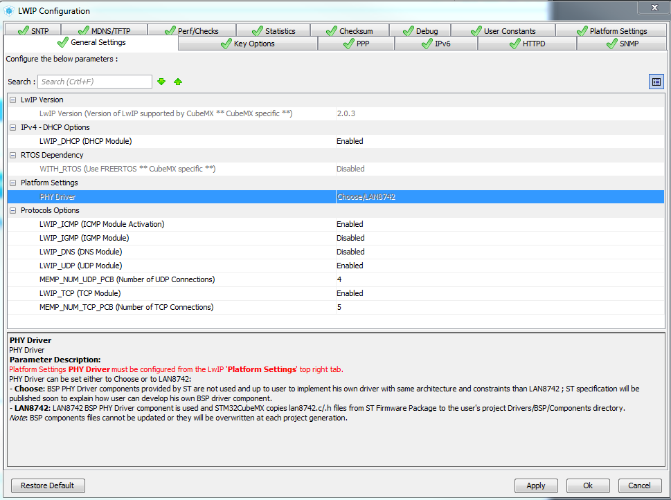

Hai , Now we are using the STM32H7 MCU in our board instead of the STM32F7 MCU .For ethernet in the STM32F7 phy drivers are given by the stm during the generation (by cubemx) only but for the STM32H7 phy drivers are not available . how to select the phy address in STM32H7 .

‎2018-03-13 5:43 AM
Hello
maheshwarreddy681
,For STM32H7, theLAN8742 PHY driver is configured from the LwIP >
Platform Settings
tab, then CubeMx copies lan8742
.c/.hfiles from the CubeH7 firmware package toyour project directory and you canmanage thePHY setting.Best Regards

‎2018-03-23 3:12 AM
Hello Lmen D ,
Thank you for the valuable reply , I had changed the Phy settings as mentioned above still the Ethernet is not working i.e i'am unable to send the Packet out . Is their any special clock settings are needed for the Ethernet.
