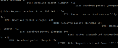

Hi @STackPointer64 , I was busy with some other works for the last week.
As you suggested I used the LwIP_UDPTCP_Echo_Server_Netconn_RTOS and the integration was successful.
  1.  I used the stack size 512*4
  2. As you mentioned using ethernetif_input inside the for(;;) loop, i expect it to do polling and i feel its correct for my requirement.
  3. I followed this  https://community.st.com/t5/stm32-mcus/how-to-use-the-lwip-ethernet-middleware-on-the-stm32h5-series/ta-p/691100#:~:text=This%20article%20presents%20a%20tutorial%20on%20manually%20importing,STM32H5%20microcontroller%20series%20without%20relying%20on%20the%20STM32CubeMX. for developement

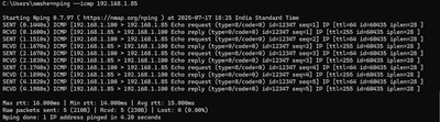

  4. Present condition is that the normal ping from PC isnt working, it showing request timed out. But the ARP resolution is working and i can see th log on uart (Pls refer the screenshots attached)
  5. But nping from works well and getting response (Pls refer the screenshots attached)
  6. I can see the traffic on wireshark aswell
  7. Tried turning off the firewall etc..
pls help me with this case..
