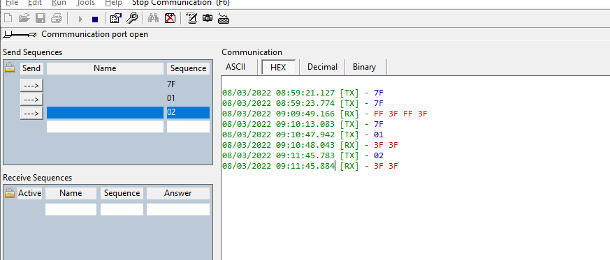

hi, i'm using a STM32G491 and i can't use embedded bootloader over UART1.
i'v set BOOT_LOCK(bit) to 0, Boot0(pin) to 1, nBoot1(bit) to 1 ans nBoot_SW(bit) to 1.
when i try to connect the mcu to STCubeProgrammer over UART i receive this message error:
 17:18:05:955 : Serial Port COM7 is successfully opened.
 17:18:05:955 : Port configuration: parity = even, baudrate = 115200, data-bit = 8,           stop-bit = 1.0, flow-control = off
 17:18:05:955 : No Init bits value is : 0
 17:18:05:955 : Sending init command:
 17:18:05:957 : byte 0x7F sent successfully to target
 17:18:07:956 : Wait ends after 1 loop, dataready = 0, delay = 2001
 17:18:07:956 : Timeout error occured while waiting for acknowledgement.
 17:18:07:956 : No response from target received
 17:18:07:957 : byte 0x7F sent successfully to target
 17:18:08:056 : Wait ends after 1 loop, dataready = 0, delay = 100
 17:18:08:056 : Timeout error occured while waiting for acknowledgement.
 17:18:08:056 : No response from target received
 17:18:08:056 : Error: Activating device: KO. Please, verify the boot mode configuration and check the serial port configuration. Reset your device then try again...
 17:18:08:128 : UART PORT CLOSE
someone can help me?
Is this a custom board?
What type of serial connection?
To what pins?
Is board otherwise functional? Can you connect via JTAG/SWD?
UART expects 3V CMOS levels, not RS232
Have you scoped the pins, can you send the 0x7F data pattern via other tools/terminal? Any response there?
Any other pins listed in AN2606 with active signals? ie GPS/GNSS receiver connected to secondary UART?
State of NRST pin?
ERazz.3
yes, it's a custom board.
"What type of serial connection?", pardon, what do you mean?
the serial is connected to pin PA9, PA10.
yes the shield works and I can connect to it via jtag.
i've tried to send pattern via minicom (on raspberry pi CM4) and docklite (windows 10 pc).
also in this case I have not received any response.
the state of NRST pin il high when i try to send 0x7F

0693W00000KblTiQAJ.pngI correct myself.
only now, after many attempts. i got something on serial. (using docklight)
