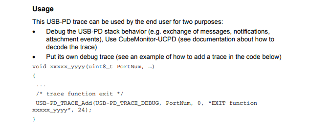

Yes our system allows to add your own debugging trace, please see below an extract from the user manual
BR
Dominique

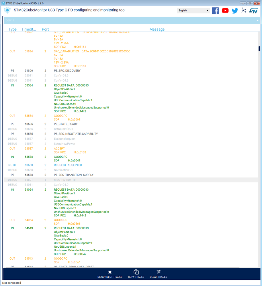

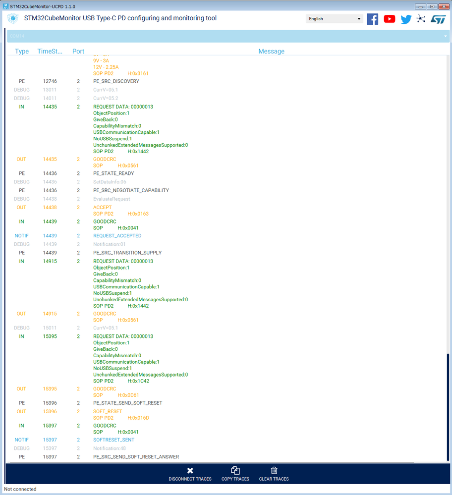

Please find attached screen capture of USB-PD trace,
I now solved most of the problem and communication with device seems goes smooth, however after device sent a request, from your manual UM2552 USBPD_PE_RequestSetupNewPower should have been called after PE_SRC_TRANSITION_SUPPLY, and I have a debug trace simply write "SetupNewPower" to ensure that function is called, but as seen from the screenshot no such thing is written and break point there is not invoking confirms that function is not called at all, I guess that's why a soft reset/request loop keeps going on without success, can you please provide me some clues why is this happening?

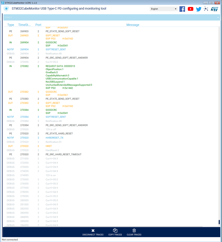

And also after my board as a source sends hardreset with USBPD_PE_Request_HardReset, no USBPD_HR_STATUS_START_REQ callback is received after PE_SRC_HARD_RESET_TIMEOUT.
And btw I tried forcing a PS_RDY signal by focing SetupNewPower after EvaluateRequest, which in turn calling USBPD_PE_Request_CtrlMessage, but returned with USBPD_FAIL.
