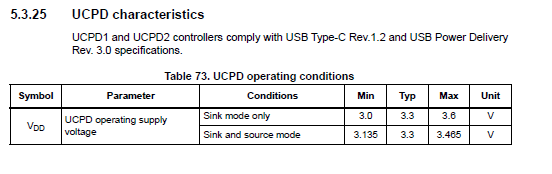

About the question 2, you must take care about the operating condition (see chapter 5.3.23 of the STM32G071CB datasheet)
BR
Dominique
‎2019-07-23 2:49 AM
Hi Dominque
Yes I do take notice and asked our hardware guy to bridge the mcu to 3.3V, because we already noticed another problem that not even GoodCRC is sent from any device, so we checked hardware and the upper bound voltage of CC line is only 0.74V, much lower than requried 1.04-1.2V per PD specification.
Anyway, I can confirm that raising the voltage of VDD to 3.3V solved my question 2, but we still don't get any GoodCRC just for your interest :(

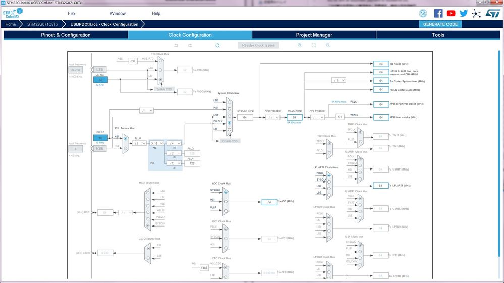

This issue could be link with the system clock please could you share the sytem clock configuration ? to make working UCPD, HSI clock shall be enabled.
To check if the problem is linked with the system clock please could use the settings from our G0 demo
BR
Dominique
‎2019-07-23 5:23 AM
Hi Dominque,
Attached is the settings from STM32CubeMX, from what I can see it should be the same as G0 demo except PLLN/PLLR, but final clocks are the same

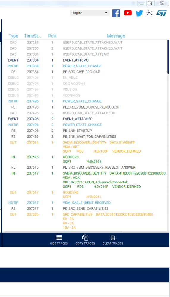

Please could you send me the USB-PD trace ? i could help you to analyse if there is an issue.

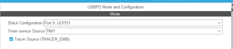

FYI, our software solution embedded is own trace system which could be a great help to analyse USB-PD issue. So i recommend you to enable it, this could be done through Cube-MX (enable the utilities TRACER_EMB and tick the box "Tracer Source (TRACER_EMB)"
And you shall use the UCPD Monitor tools to catch the trace

Yes, we do enabled tracer_emb from the start, unfortunately the board 3.3V buck failed (possibility due to all those mods on the board :( ) and our hardware guy is fixing it, so until the board work again there is nothing for me to do right now.
