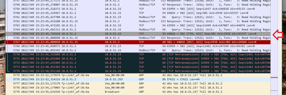

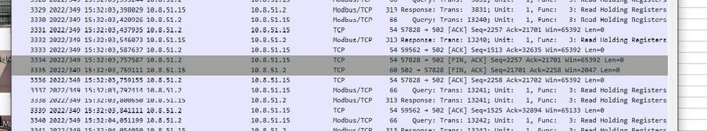

In addition, I attach a wireshark capture when the master (10.8.51.2) request the end of the connection and the problem doesn´t occur:
But when the problem occasionally occurs, there is a RST:
Please consider in both captures that I have more than one connection at the same time between master and slave, that's the reason there is activity after the desconnection (belongs to other ports

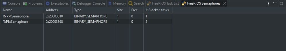

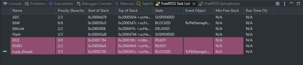

Hi, thanks for replying
I did what you suggest and here is the capture:
There is a callback interruption that releases the semaphore:
void HAL_ETH_TxCpltCallback(ETH_HandleTypeDef *handlerEth)
osSemaphoreRelease(TxPktSemaphore);
The interrupt never seems to happen and of course this blocks execution.
In addition, I reached to the function vListInsert() in list.c [FreeRTOS]. There is a "for" sentence and the exceution keeps there forever. Inside the function is a note:
