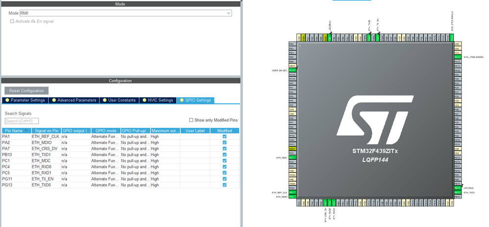

Ethernet is enabled
Ethernet interrupt is enabled.

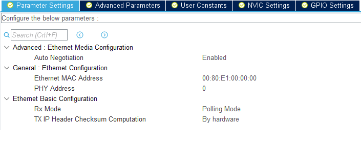

The parameter settings:

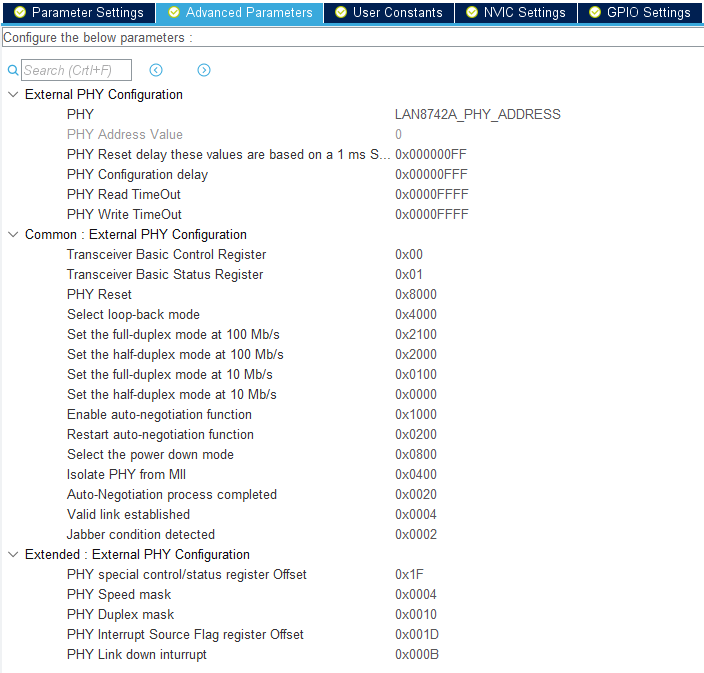

0690X000008B5euQAC.pngAnd the advanced parameter settings:

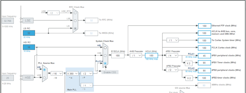

The clock configuration:

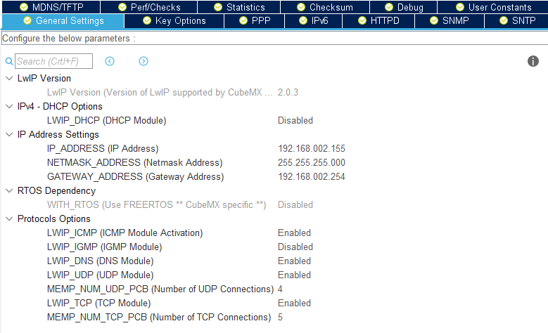

LwIP is enabled, general settings (Ive tested with bot static and dynamic IP, both wont work):
I left most of the LwIP options at standart, except i set
LWIP_BROADCAST_PING (Respond to Broadcast Pings) Enabled
LWIP_MULTICAST_PING (Respond to Multicast Pings) Enabled
Also CHECKSUM_BY_HARDWARE is enabled, as well as all the CHEKSUM_GEN_*** and CHECKSUM_CHECK_***

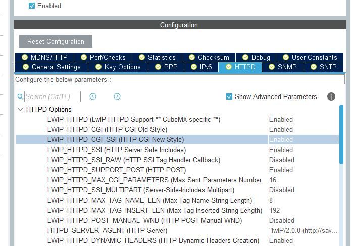

After i enabled LWIP_HTTPD, LWIP_HTTPD_CGI and LWIP_HTTPD_SSI and added httpd_init(); to main.c,i get the compiler error:

I found the source of the problem though: The function httpd_cgi_handler(); is called
httpd_cgi_handler(uri, count, http_cgi_params, http_cgi_param_vals
#if defined(LWIP_HTTPD_FILE_STATE) && LWIP_HTTPD_FILE_STATE
         , hs->handle->state
#endif
and also declared in the header httpd.h
extern void httpd_cgi_handler(const char* uri, int iNumParams, char **pcParam, char **pcValue
                                     , void *connection_state
#endif
but there is no function definition. Its simply missing. So i put the function call into comments and the code compiled as it should.
I guess thats a bug with the generated code from CubeMX.
Hi.
httpd_cgi_handler(..) must be defined by the user.
In general, when the user wants to install one or more CGI callbacks , must use http_set_cgi_handlers(CGI_arr, x);
CGI_arr is an array of tCGI type, "x" is the number of handlers contained in the array
Install one callback func like this "tCGI CGI_arr[1]={{"/config.cgi", usrCGIHandler}}; //usrCGIHandler is the user handler
So you can call http_set_cgi_handlers(CGI_arr, 1); to install this handler.
A "workaround" not to have this link error is to disable
this "HTTP CGI NEW STYLE"
Here are some data from LWIP site
