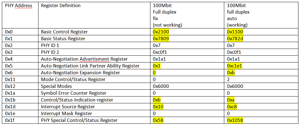

I recently migrated an own board from a STM32F437 to a STM32F767 controller.
I use the HAL Library (and freeRTOS), and cubeMX to generate the code.
Everything worked fine with the M4 controller, but on the M7 controller, I only have a 10BaseT connection, a 100BaseT connection will not work at all!
Doesnt matter if I'm using autonegotiation or not...
I use a LAN8720A controller with RMII. The ioc file from cubeMX is migrated to the new processor. Everything else works fine (CAN, uart, spi, timers etc)
Can anybody figure out the problem?
Thanks in advance!

Piranha
Chief II
Check if PHY extended status register and speed/duplex flags are correct. Look for them at "Section 4: Extended PHY Registers" in stm32f7xx_hal_conf.h file.

AlexF
Okay, in the meanwhile I have the following facts:
Autonegotiation works with 100BaseTX full duplex. In this case the PHY_SR is 64 (0x40)
When I set 100BaseTX full duplex without autonegotiation PHY_SR is the same 0x40 after config, but I cant establish a connection.
When I read the definition of PHY_SR the 0x40 bit is RESERVED.
AlexF
The Special Contraol and Status Register on adress 0x1f is:
Auto-Neg: 0x1058
100BaseT full: 0x0058

AlexF
0690X000008iBMOQA2.pngI am struggling with the original thread: When I dont use autonegotiation, it doesnt work. Not on the M4, not on the M7.
If I use autonegotiation, 100MBaud full duplex is selected.

In the attached picture, there are my registers, for both fix and auto-negotiated.
Anyone has a clue? Every hint is appreciated.
