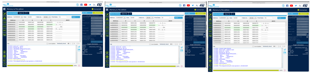

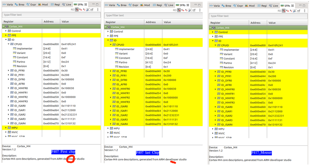

‎2021-08-28 04:20 AM
Hello Tesla DeLorean, all other, Yesterday I finally received new F407 chip.
Applied to a new board it work and respond to ping. Now 3 board are complete, F407 With name First doesn't work. F407_Last and F417 work.
Attached are images from CubeIde register and from Cubeprogrammer, all MCU return same ID, just F417 report version Y instead of version 2.0.
Also attached as Zip the text dump of all register by part.
Hardware test:
On board F407_First try'd rework PHY, no success, New PHY still complete negotiation and link but no MAC TX activity.
Don't rework F407 for now I reserve do some Inspection on.
Software test:
traced init, HTTP task is not activated, terminate with memory allocation error... ??? ...
Increased Heap from default 15360 to 32K HTTPD task was correctly spawn.
Still slow when image file are accessed but now both 407 and 417 perform same way. First board remain behind dryer waiting some new hint to address failure reason.
