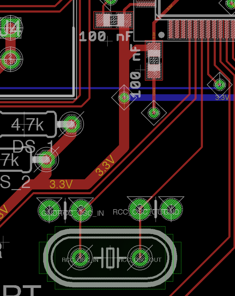

Thanks for this guide. Looking through it, I don't think my circuit oscillates. I attached a picture. I believe to fix it I would need to match trace lengths, and then possible add a resistor on the OSC_OUT line, as well as move the crystal closer to the chip. Would those be your suggestions? Thanks again. The top right is the input to the STM32. Right now (this might be wrong math wise) but I am using a 16MHz crystal with both capacitors set at 1 nF.
‎2018-01-26 12:36 PM
Looks like you could get it closer.
I'd be more concerned with the specs for the parts chosen/placed, especially if the schematic values were just cut-n-pasted from some other design. Review the BOM from a DISCO/NUCLEO board
You might need different capacitors, or series resistor, if the crystal characteristics are different.
‎2018-01-26 1:03 PM
1nF is way too much.
Read AN2867.
‎2018-01-26 2:54 PM
Something like this I'd start with 10pF caps
