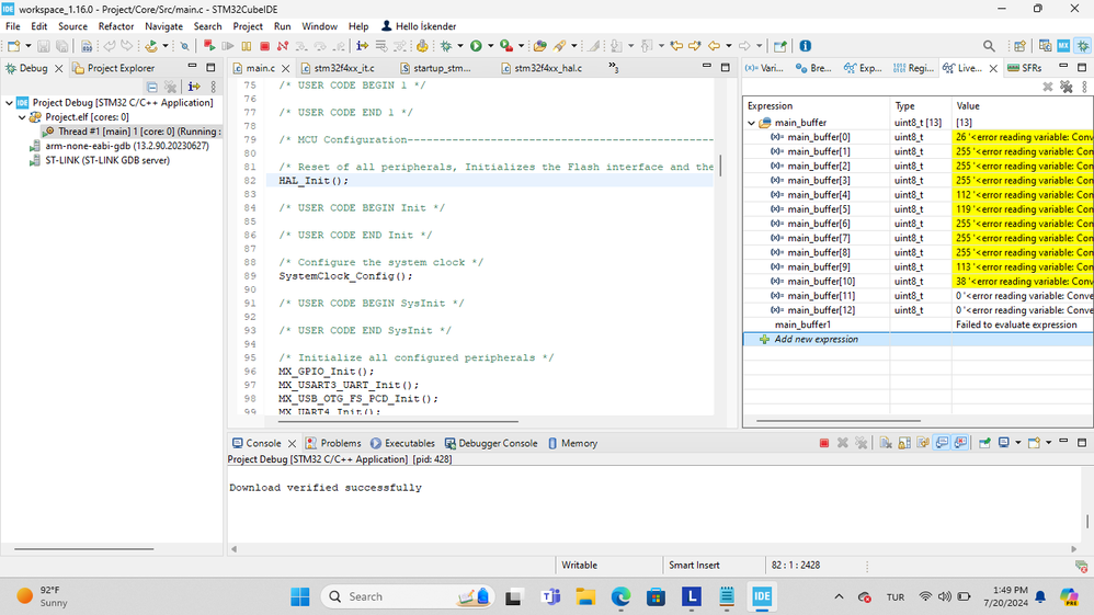

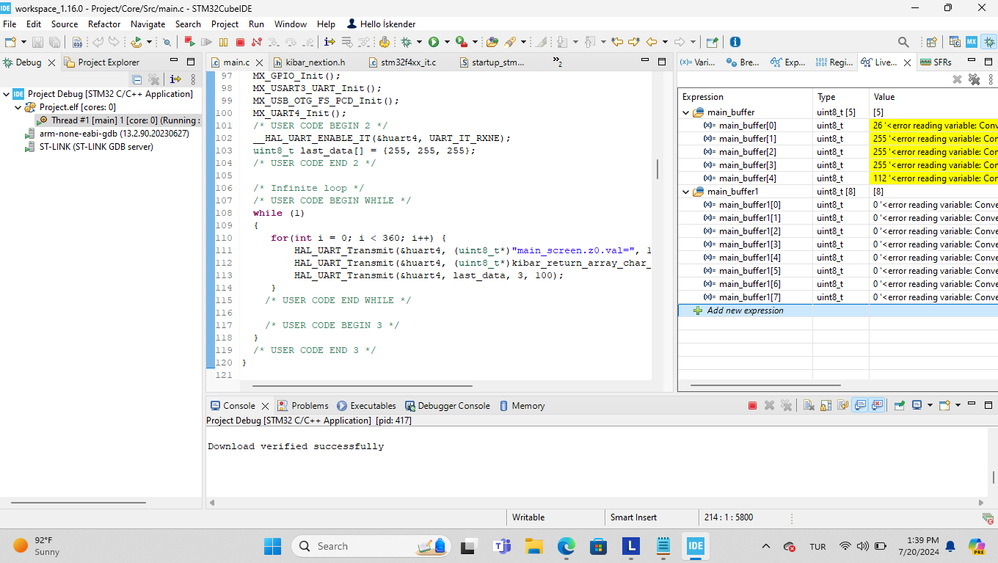

Yes, the interrupt works, but there are some problems. Firstly, I am using the UART connection on the STM32F413ZH board and trying to send and receive data from a Nextion screen. There is no problem when I only send data, and there is no problem when I only receive data. However, when both are done simultaneously, problems start to occur. From the Nextion screen, the first 5 bytes received are a name, followed by an 8-byte number. When I implemented your suggestion, the data transmission part improved, but as shown in the attached image, the 5-byte data is not received correctly, and the 8-byte data is not received at all.

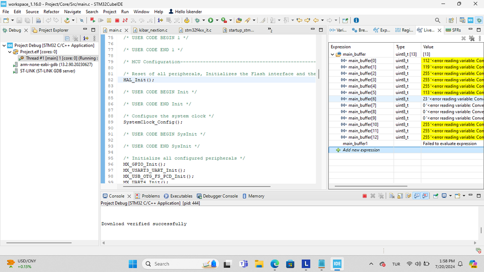

Another solution I can think of is to directly read either 13 bytes at once or read one byte at a time and save it into a 13-byte buffer. However, when I do this, I encounter the following result.
As you can see, the received data is still corrupted. However, if I turn off data transmission, then the first received data is correct, but data reception will stop. Here's the code where I have disabled data transmission and the image of the received data:

void UART4_IRQHandler(void)
HAL_UART_Receive_IT(&huart4, main_buffer, 13, 100);
HAL_UART_IRQHandler(&huart4);
I believe I have explained my issue in more detail this time. Thank you for your help if you can assist me.
