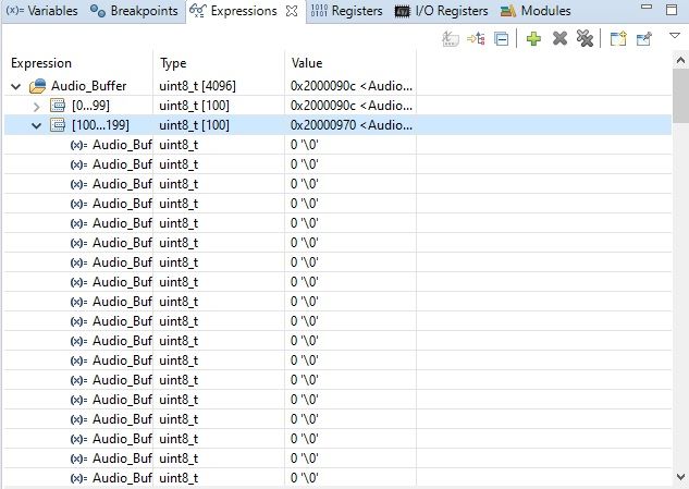

Hello everyone! I'm working on a project like Audio Playback. I have tried compile and run Audio_playback_and_record from ST's Firmware pack its working good.
I'm trying create my own project file, i'm stuck in read wave data from usb. I can get waveformat data but i cant get audio data.
I have tried debug results are bellow;

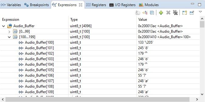

Audio_playback_and_record inside audio buffer data;
And my own project inside audio buffer data;
As you can see there is always '/0' except 0-99 indexes(that's include audio format data like wave, riff.)

2019-12-09 03:40 AM
I mean, i can get waveformat data from file(FileSize, Byterate, Samplerate.. etc) but when i want read audio data i getting just zeros

2019-12-09 06:01 AM
I can read header and i've tried read data after header, that doesn't work. The point is i get receive the same data continuously as '/0'
I assume you compared with the actual file contents.
Have you checked the return value of f_read(), and the "bytesread" variable ? Your posted code does not.
I would check, perhaps in a debugger.
