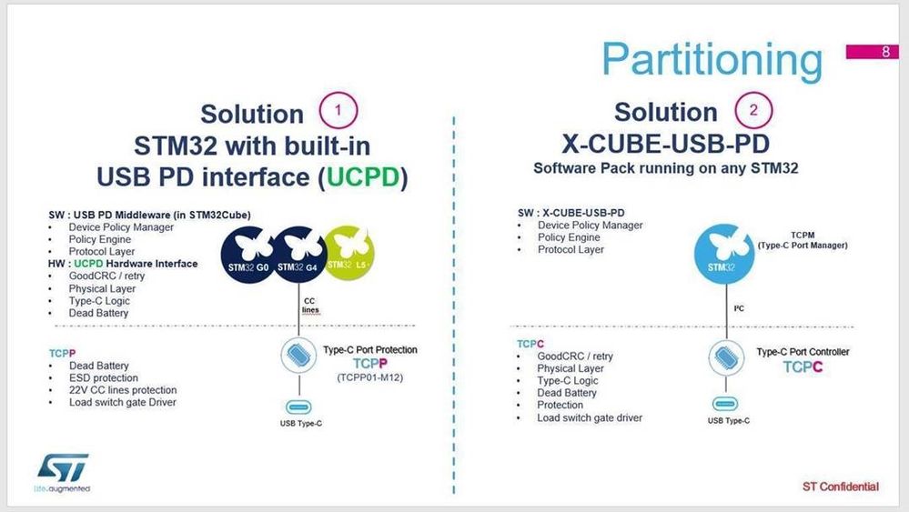

‎2019-12-06 12:45 AM
Dear @TSaku.2135​ ;)
We did not deliver VCONN applications on X-CUBE AFE solution. This solution is no more supported for P-NUCLEO-USB001.
In addition to this solution, we have introduced traditional STM32 MCUs with native hardware interface (called UCPD) to support USB-C and Power Delivery Technology.
This solution �?� described below, is available in STM32G0, STM32G4 and STM32L5 product families.
It comes with a complete ecosystem (such as a discovery kit and a debugging tool) that simplifies UCPD configuration and use.
USB PD middleware stack is now part of STM32Cube (so X-CUBE-USB-PD expansion pack is not needed anymore when this solution is selected)
To make this new solution even more attractive a companion Type-C Port Protection (TCPP01-M12) is available to protect the CC lines against ESD and short to VBus.
Further information on that new offer are available here after.
- STM32G0 USB-C marketing presentation : link
- Getting started video with USB type-C and STM32G0 ecosystem : link
- Create a USB Power Delivery sink application in less than 10’ : link
- STM32G0 series : link
- STM32G071B-Disco data brief : link
- STM32G071B-Disco User manual : link
- STM32CubemonUCPD (USB PD Software debugging tool): link
- STM32G0 Online Training : link and a specific training on STM32G0 UCPD interface here
- Specific Application Note AN5225.
Anyway, you will find in EVAL-G0 demonstrations code ('.\Projects\STM32G081B-EVAL\Demonstrations\DemoUCPD\') the way to manage VCONN in the FW package.
