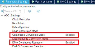

  • Which STM32F4 part number you're using?
  • You need to enable continuous mode on ADC and DMA :

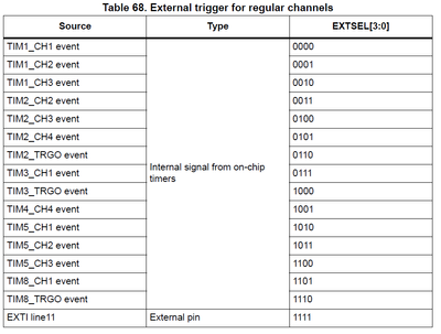

  • This is the list of ADC internal triggers for regular channel conversion (from RM0090:(

Thank you for your replies. I did a check on the ADC_CR2 bits by reading them. I found the value after all the initializations, to be 0x400. Just the EOCS bit is set. So I did a brute force setting of the EXTEN bits by
ADC1->CR2 |= 0x30000000;   How to set these bits through the HAL call?
After this to start one set of conversions I called -> HAL_ADC_Start_DMA (&hadc1, (uint32_t *)adc_buf,ADC_BUF_LEN);  This seems to convert. TIM1_CH1 event value is 0000 so left it as it is. Sharing the project is no issue but the entire code is in a mess. I have several unused functions etc. I am posting the ADC init code. Here is the timer code
