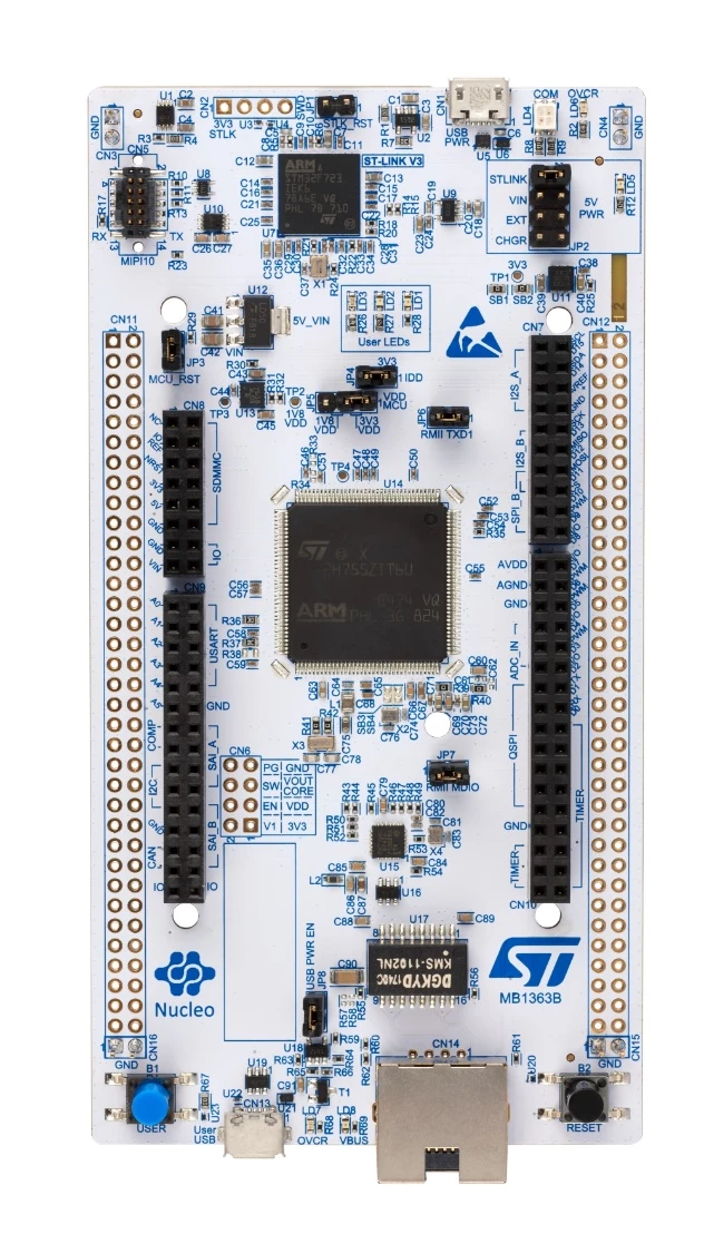

  1. Open STM32CubeIDE and create a project using the board NUCLEO-H745ZI-Q

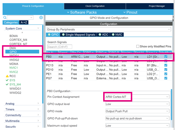

  2. GPIO configuration
STM32CubeIDE, by default, will initialize a GPIO for the on-board green LED (PB0).
Please change “Pin Context Assignment” to ARM Cortex-M7 as shown in the screenshot below.
Make sure the configuration of PB0, which is the GPIO being used is configured as follows:

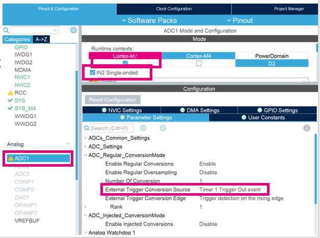

In this section we will configure the ADC1 peripheral of the STM32H7 as follows:
  • Single Conversion on channel 2
  • Regular conversion mode
  • Triggered by Timer 1 trigger output

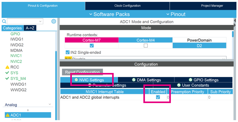

  • Enable interrupts for ADC1 so that the GPIO can be toggled at the end of the ADC conversion in the call back function.

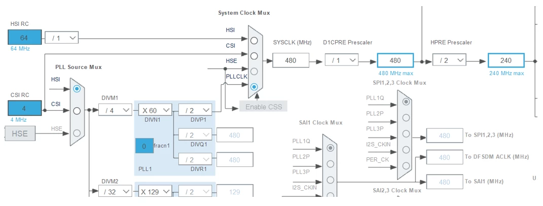

  1. Clock Configuration: 480/240 MHz
We are running the STM32H7 at its maximum speed: 480 MHz for the system frequency and 240 MHz for the peripheral bus frequency.

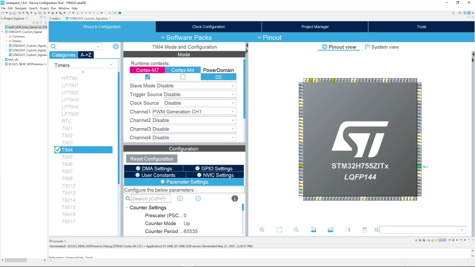

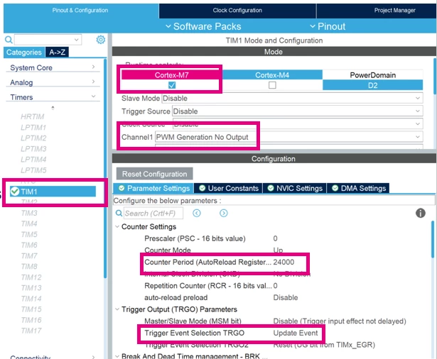

  1. Timer Configuration
In this section we will configure the timer that will be used to trigger the ADC conversions per the following:
  • PWM generation, no output needed since timer is triggering ADC internally
  • Auto Reload Register (ARR) set to 24000 will yield 10kHz sampling frequency:
  1. TIMclk / ARR = SamplingFreq
  2. 240MHz / 24000 = 10KHz
  • Trigger out set to Update Event i.e. trigger event every time the timer counter reaches ARR

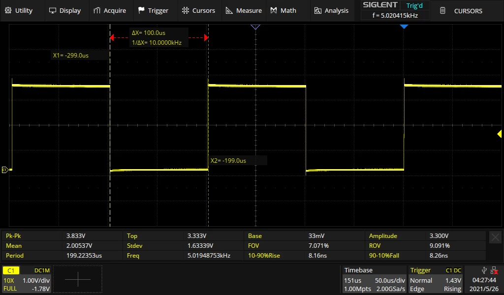

The green LED is toggling every 100 us indicating the ADC is sampling at the desired 10 kHz rate.
Here is an oscilloscope capture that shows the green LED GPIO toggling at the desired rate:
