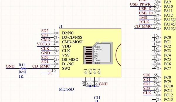

Hi All
I am Using STM32F207VC And Micro SD Card With SDIO Interface And Fatfs Library
When I Debug And Trace Code, SDIO Routine Response This Error:
/*!< Card is not V2.0 complient or card does not support the set voltage range */
What Is Mean?
What Do I Do For debug This Error?

Posted on July 11, 2016 at 14:09
Describe the specific card (make, model, capacity, etc) you are having problems with. Are other cards working? Is the interface wired correctly? What board is this?
Make sure the SDSTATUS_Tab has 64 elements.
The error seems to suggest the card is non-responsive
Test the code/card on known working hardware.
e_j_g
Posted on July 11, 2016 at 14:53
hi clive And Tanks For Response
I Read A
Article
?About SDIO Interface
http://blog.frankvh.com/2011/09/04/stm32f2xx-sdio-sd-card-interface/
That Write About Hardware That must Use A Buffer For SDIO Voltage
My Board Dont Have Any Buffer And Connect MicroSD Driectly To STM32F207VC
Is There Any Issuse For This Problem?
Posted on July 11, 2016 at 21:47
I have my card detect with a pull-up, the socket grounds the pin.
You'd need to make sure you use external pull-ups on the data, and command pins, or configure them with pull-ups. This configuration works for an assortment of F2 and F4 boards.

The SDIO requires the PLL to be clocking to function. A board running at 2.7 - 3.3V shouldn't require any voltage adjustment. I'll assume no cards are working..
