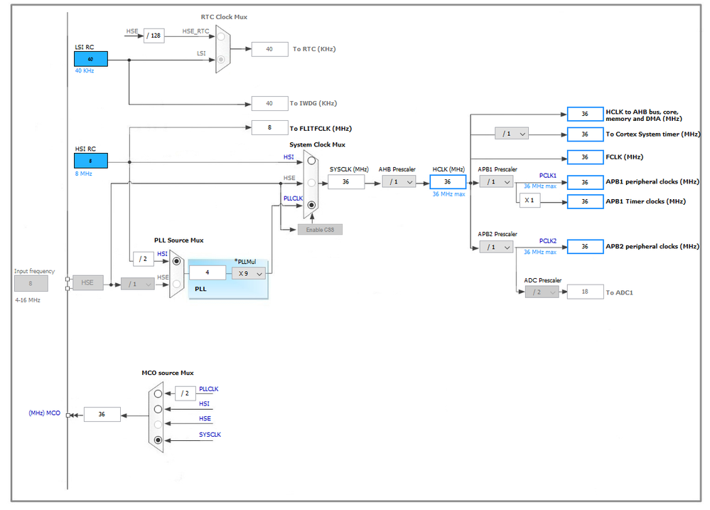

I'm working on a new project, 2 boards: STM32F101CBT6 and STM32F101T6U6ATR.
I've generated a project/code via Cube (which has many advantages), but, similar to other posts - the HAL layer is, simply, lot's of code which make things complex, but not HAL-able.
The old StdPeriph_Lib was not bad, I've used it a few times successfully.
I downloaded stm32F10x_StdPeriph_Lib_V3.5.0, but it's from 2011 - is there anything more up-to-date?
I adapted the project to my STM32F101T6U6ATR (32K flash, 6K RAM, 36Mhz), and added minimal code for a 1ms SisTick and a GPIO, which toggles every second (a simple test I do, reading with an analyzer, to test the clock) - but my 1 second is about 9 seconds!!!
What am I missing?

... - but my 1 second is about 9 seconds!!!
What am I missing?
Perhaps that obvious design bug in the SPL header files.
Check the value of the  define '
HSE_VALUE
' in your project. If you give none, it is silently set to 8.000.000 (or 25.000.000 for the CL parts) in the header
stm32f10x.h
, instead of throwing an error.
This usually makes your clock setting fail, and fall back to the default HSI clock.
Posted on February 16, 2017 at 10:52
I did use both for reference.
Toggling a GPIO works.
Receiving SysTick interrupts work.
Only the timing is terrible.
The STM32F101 family work on 36MHz and the board I'm currently testing has no external clock.
It's not a value line, so I use the STM32F10X_LD define.
My '1000ms' toggle turns out as 4.486 seconds.
4.486 * 8MHz ~= 36MHz.
HCLK_Frequency
is 8,000,000, when calling:
RCC_GetClocksFreq(&RCC_ClockFreq);
even though
SystemCoreClock
is 36,000,000.
I must admit that configuring all these clocks/plls is new to me.
Posted on February 16, 2017 at 11:09
... even though
SystemCoreClock
is 36,000,000.
Read the comments to the
SystemCoreClockUpdate()
function in system_stm32f10x.h. The (initial) value of the
SystemCoreClock
variable is not necessarily correct. Or rather, it is initially incorrect, since it is initialized to the target clock frequency before the function
SystemInit()
is called.
Posted on February 16, 2017 at 11:12
In this board I don't have an HSE - I'm supposed to use the HSI.
Posted on February 16, 2017 at 11:19
This is the clock configuration that works fine, created by the CubeMX.
Posted on February 16, 2017 at 12:20
That is o.k., but you need to check if the files
system_stm32f10x.c
and
system_stm32f10x.h
match your purpose. They had usually been generated by an Excel Sheet (perhaps still found somewhere on the ST downloads) for a specific configuration. The SPL examples mostly use the same configuration (HSE, max. core clock), which is not what you want then.
I suggest to step through the system init code with a debugger (or just read it), and see what it actually does and what changes you would need to make.
Posted on February 16, 2017 at 12:26
I agree... bummer... hoped someone has done it already
thanks
