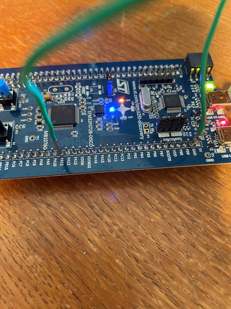

I am attempting to use the USB designated pins (PA11 and PA12) as generic GPIO inputs at start-up as a way of determining if a host is connected to the device and make a decision whether to run the main code or not - I will have external pull-up resistors on the DP and DM lines to aid this. Whilst waiting for the board to be made I wanted to make sure I could read the pin levels at start-up - for this I used the STM32F0-Discovery board.
This is where I encountered my issue. I initially tried setting pins PA11 and PA12 as inputs with a pull-up resistor, I would then use a 'flying wire' to alternate the pin voltage between 0V and 5V. I then set up the code such that the LEDs would change state depending on the input pins. The code can be seen here:

No matter what voltage/logic level I applied to the pins the LEDs did not change state.
I then set PA11 and PA12 as output push-pulls, made them write high, and used a logic analyser to scope the pins. With this set-up the pins should have been outputting a logic 1, however they remained at 0!
In short, I do not seem to be able to use these pins as regular GPIOs. I have tried looking through the documentation for any reference to this behaviour but came up with nothing. I know it is not how I am setting the pins up as applying the same process/config to PA9 and PA10 yields the expected results.

JCame.1
Hi TDK,
> IDR following the pull resistor but not your input would suggest you're not applying the input to the pin. Where exactly are you applying the flying pin?
That would be my assumption as well. It almost seems as though the pin on the board isn't physically connected to the chip. I have a lead connecting PA11 to GND on the discovery board as shown in the photo.0693W00000BcgpBQAR.jpg

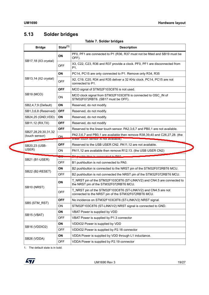

waclawek.jan
By default, it isn't.
0693W00000BcgsFQAR.pngJW
Ah that would explain a lot. Thanks a lot for your help, I should've looked at that document a lot earlier. I'll join that bridge and report back whether it springs back to life (which I am very certain it will).
I checked the schematic beforehand and it did not show these solder bridges.
Turns out the issue was that I was looking at STM32F0-DISCOVERY board (per the OP), whereas the OP actually had the 32F072BDISCOVERY board, despite it saying "stm32f0-discovery" on the board itself. The OP also says STM32F072xB so can't really fault.

JCame.1
I have joined those bridges and now have the expected behaviour, thank you both for your help it is greatly appreciated.
Apologies for any unnecessary confusion I caused, I was not aware there were 2 evaluation boards (with a similar name) and somehow didn't notice that even with the page JW linked - that'll teach me to take a bit more time reading next time.
