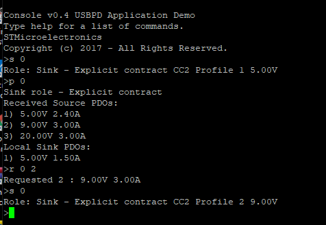

PNUCLEO_USB001-DEMO1.bin result

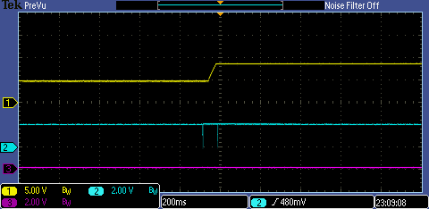

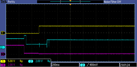

it identifies the source(usb pd capable psu). The yellow waveform is VBus others are cc
successful transaction from 5V - 9V

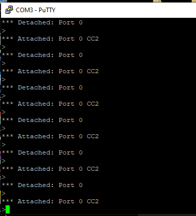

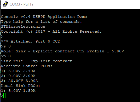

Consumer(Consumer_CLI_RTOS) example code result
here, it looks like it is trying to establish connection to the source but couldn't.

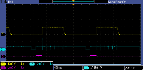

here is the waveform.

Quick analysis:
  • CC attached
  • VBUS set by provider, sink goes into PE_SNK_WAIT_FOR_CAPABILITIES state
  • No src capa received by sink after 500ms, stack sends a HARD_RESET to provider
  • Wait for VSafe0V and then VSafe5V but VBUS is not more available => DETACHED !!!
(etc...)
Problem is linked to the fact than SRC_CAPA is not sent by the provider or not seen by the consumer !
