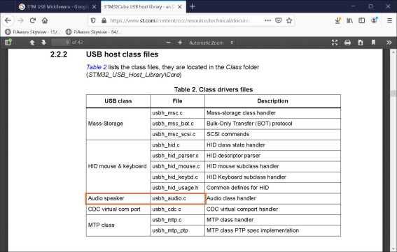

As I see right now in some manuals - the Host Audio (MIC) Input is not officially supported (just Host Audio Output to a speaker).
how to add/extend for Audio Microphone?
