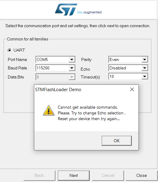

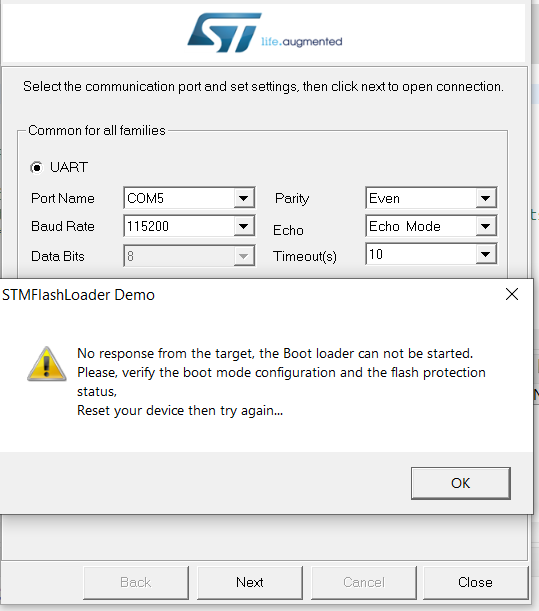

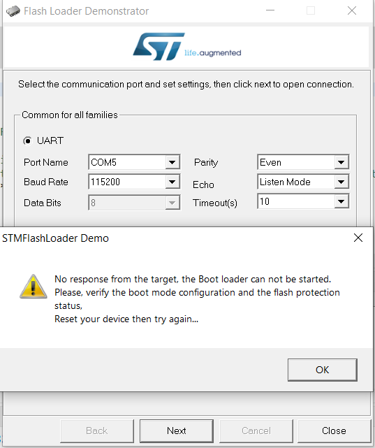

So now it doesn't end up in a Hard Fault interrupt. However, I haven't been able to connect using the Flash Loader Demonstrator. I have tried all 3 options for Echo without luck.

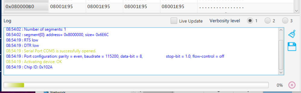

Using the STM32CubeProgrammer UART, I get it to connect, but haven't been able to flash anything. It stays with the loading bar ping-ponging without ever increasing from 0%.

‎2021-11-21 6:20 AM
Try ommit the call to __disable_irq();
‎2021-11-21 6:41 AM
Thanks for the follow up. I tried, but if the interrupts are not disabled, for some reason it resets after calling the SysMemBootJump.
‎2021-11-21 9:19 AM
You need disable interrupts one by one before call Bootloader start.
‎2021-11-21 11:18 AM
Thanks for your assistance. Based on your input I decided to call the DeInit functions for each and every peripheral currently used by my application as well as disabling all interrupts enabled by my application. I followed the reverse Initialization order while doing it.
