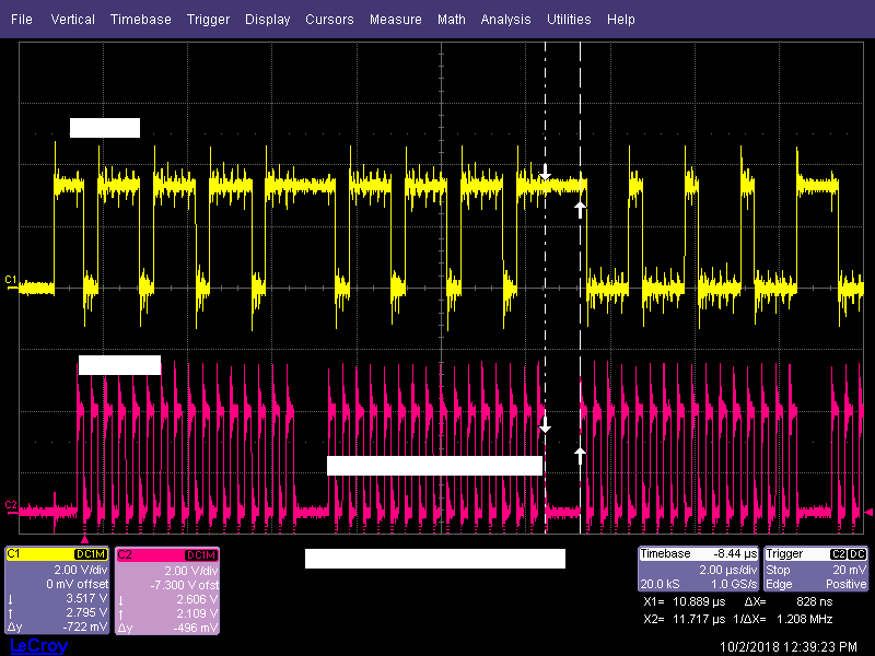

Hello
Is there a possibility to reduce the time gap between two consecutive SPI Frames? Background: I would like to use only the MOSI signal without the clock to send information to some addressable LED (WS2812). They just measure the time between rising and falling edge of the signal to determine the data. With gaps between the frames, the timing of the MOSI signal is destroyed for a MOSI without Clock usage.

  • SPI Configured with baud rate 3MBit/s, 16bit data size, transmit only, SPI Tx DMA, highes priority

With an attached scope, I can measure that the data is transmitted.
But between two blocks of 16 bits, there is a time gap of about 660ns (about two bit times) is there a possibility to reduce that gap close to zero so that no time space between the frames can be seen?

Best answer by waclawek.jan
> hspi1.Init.NSSPMode = SPI_NSS_PULSE_ENABLE;
is what makes the spaces between frames.

waclawek.jan
waclawek.janBest answer
October 3, 2018
marco.erni
October 4, 2018
Thank you for your answer. This solved the issue.
Thanks a lot for your help.
Best, Marco
