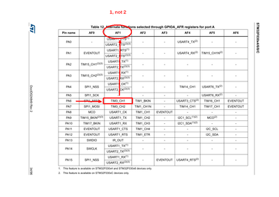

I am a beginner. Please help me figure out why the interrupt is not happening. I want to measure the duty cycle, but the interrupt is not enabled. I am losing hope that this is possible.

waclawek.jan
GPIOA->AFR[0] |= (0x1 << GPIO_AFRL_AFSEL6_Pos);

waclawek.jan
> GPIOA->AFR[0] &= ~(GPIO_AFRL_AFSEL6);
> GPIOA->AFR[0] |= (0x2 << GPIO_AFRL_AFSEL6_Pos);
PS. Don't RMW TIMx_SR. Make sure variables you share with interrupts (here cnt) are qualified as volatile. Be careful with modifying GPIO_ODR in interrupts; better use GPIO_BSRR.
Thank you. I still don't understand how to fix the situation.
waclawek.jan
Thanks. I seem to be getting timer interrupts. The code still doesn't correctly determine the pulse length. Could it be that the falling edge of the signal is not set correctly?
