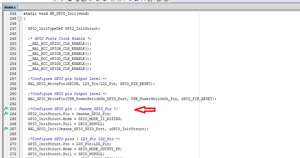

perhaps I missed something... Is it correct, that the user labels in CubeMX are not used in the generated code? I've seen this in other code configurator tools. I didn't found a way to benefit from the pin definitions in the code, like ''LED_RED''.

Posted on January 10, 2018 at 06:35
I have a colleague using
Version 4.23.0
STM32Cube V1.0
'Lord I don't understand your version numbering scheme.'
He added User Labels to various pins.
These User Labels are visible in the STM32CubeMX Pins/Signals Options... as well as in the GUI around the MCU, and also in the GPIO Pin Configuration of the Configuration Tab.
NONE OF THESE USER LABELS EVER SHOW UP IN THE GENERATED CODE? WHY? I HAD THE IMPRESSION THAT THIS WAS A FEATURE. AM I NOT INTERPRETING WHAT I AM READING HERE?

Regarding your post
tomkins.richard
, indeed, user labels are correctly generated. Here, I took an example of STM32F722ZETX with the pin PC13 named Jeanne_GPIO as below :
and after generating the code, I can find this user label in the main.c in the GPIO configuration part :
I think that fully answered the initial topic.
If not, could you please be more precise in your request?
BR. Jeanne
Posted on February 01, 2018 at 14:58
I find my user defined names ♯ defined in main.h
