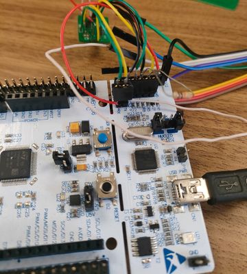

I was using a custom board for the C031G6U6 that was connected to the Nucleo's St-Link, board model MB1136. The 3V3 power comes from the Nucleo(connection made under the board), and the embedded MCU is disabled by the JP6.
Original connectionOriginal connection

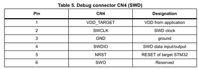

All pins were connected as described on the CN4 documentation.
CN4 PinsCN4 Pins
It was discovered that disconnecting the NRST pin from the Nucleo board eliminates the problem!
I don't know why but, that's it. The custom board seems to be ok, it already had the 100nF cap.
CN4 PinsCN4 Pins
