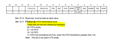

1. It it possible to clear Tx FIFO??
"FTLVL" It's not '0' value. how to make '0'?
There is no possibility to clear these bits by software. these bits are fully managed by hardware. Please take a look at the description provided in the reference manual below.
