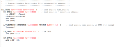

I have a problem with the SRAM. I use a stm32f303CCT and Keil. I write  a value in the SRAM memory. (0x20000000 - 0x20000008) However, after a soft reset, the SRAM value will be deleted. How can this be prevented so that the data is preserved?
The data is stored as shown in the image below.
After soft reset the SRAM is deleted.
What do I need to change in the Patter File or the startup File so that the data is not lost?

Global variables are initialized to 0 by default at the start of the program. You can carve out a ram section and mark it as NOLOAD if you don't want that to take place.

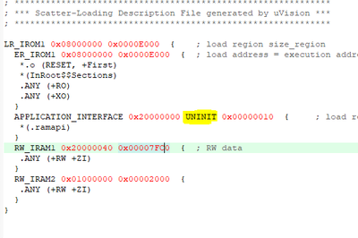

 In the "Options for Target" there is a box "NoInit" and Keil generates the UNINIT in the scatter file.
The line with UNINT should actually work, but the RAM memory area is always deleted after the software RESET.

Please set a breakpoint on the reset handler in the asm startup and look at the SRAM at that point. If the data is already lost, it is something hardware (power loss). Else it is software (initialization of this area still runs somehow).
-- Addition--
If the data is lost at this point, it can be also artifact of the debugger. Just because debuggers can do this.

The __main called in startup.s is what calls the scatterload function, and subsequently user's main() function.
Would suggest unpacking the initialization tables, might need to review .MAP, and disassemble .AXF via
FROMELF -csd  foo.axf  >foo.lst

Thanks for your help. I solved my problem using the following link
https://developer.arm.com/documentation/ka003046/latest
I made the declarations like in Compiler 5, but I have Complier 6. So the declaration must look like this:
