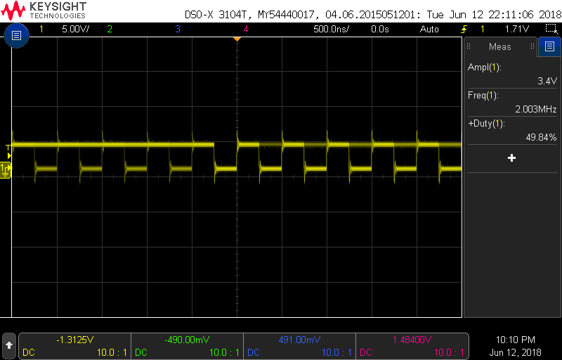

Hello, I'm working on a project involving STM32L476RG Microcontroller. I'm trying to write a piece of code for creating an SPI Driver for my project and seem to have some issues. I'm using Keil v5 IDE. The output doesn't seem to be close to my expected behavior of the Microcontroller.
My logic analyzer output is below. My clock is irregular and MOSI has garbage data. Anybody with any leads, please do let me know. Thanks in advance for your valuable time.

                  Thank you so much for your reply. I'm using a third party device, i'm not sure whether it is possible to reduce number of channels. Instead, i'm using a keysight infiivision oscilloscope instead. I'm not able to control the frequency by varying parameters (like Baud rate,etc.,). If some leads, please do let me know. Thanks in advance.

Posted on June 12, 2018 at 17:08
Are you saying you cannot change the SPI clock frequency? Or the sample rate on the o-scope or logic analyzer? TO slow down the SPI clock rate (and allow the logic analyzer to hopefully see things), change your line in ST_SPI_Init() from
MODIFY_REG(SPI2->CR1, SPI_CR1_BR, 4);
to some higher number. 4 means clk/32 on a 32L433, I presume its the same on your CPU, so try 5 (clk/64) or 6 (clk/128) or even 7 (clk/256) - THAT should really slow down your SPI clock. If you are saying that you have tried changing that line and the SPI clock rate remains the same, then something is messed up elsewhere in your code. Or you aren't running the code you THINK you are running.
When using your digital scope - set it to 'single sweep' mode, with manual trigger (or whatever it calls the opposite of 'auto' trigger). The screen shot you posted shows many sweeps over top of each other. The only clock pulse that is clean is the one that the scope triggered on. The others are sometimes a clock pulse and sometimes just 'high' determined by when the scope semi-randomly re-triggers on a clock pulse SOMEWHERE in the bit stream. By using single sweep you will be see one scope sample.
Posted on June 12, 2018 at 17:57
Hello Bob,
Thank you for your suggestion. I got the SCK clock working better right now.
I had previously tried MODIFY_REG(SPI2->CR1, SPI_CR1_BR, 4); with all values, but was not useful. But with little more deeper insight,
used MODIFY_REG(SPI2->CR1, SPI_CR1_BR, SPI_CR1_BR_0 | SPI_CR1_BR_1 | SPI_CR1_BR2 ); This helped me out.
