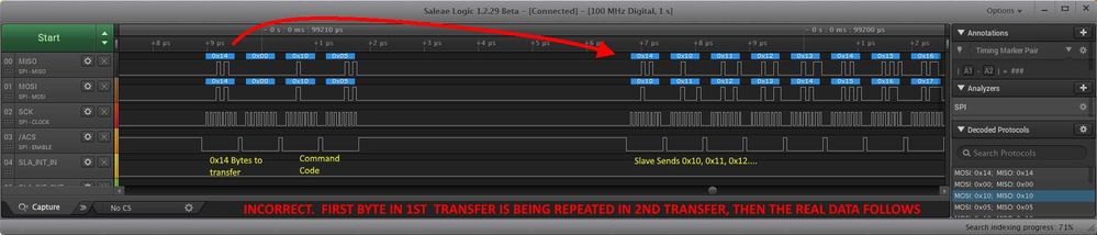

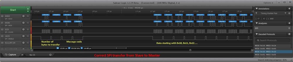

I have two STM32F7 processors set up in SPI Master/Slave configuration. When the slave wants to transmit data to the master, it issues an interrupt and the master reads 4 bytes. The first two are the number of data bytes to read, the second two is a command code. The master waits for a go-ahead interrupt, then reads the rest of the bytes.

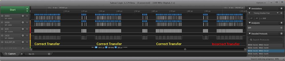

At times, I'm seeing the first byte of the 4-byte transfer duplicated in the data transfer - thus shifting the bytes by one, and adding one byte to the transfer. This may make more sense by looking at the captures from the logic analyzer. I am using HAL_SPI_Transmit_IT to the master, and HAL_SPI_Receive_IT on the master side to receive the bytes.
The transfer rate is 14 MHz. Slowing the clock down makes no difference.
Using SPI_NSS_PULSE_DISABLE or SPI_NSS_PULSE_ENABLE does not help
On the Master side, using SPI_NSS_HARD_OUTPUT or generating the NSS signal manually makes no difference.
The only thing that seems to help is enforcing a minimum transfer rate of 2ms. In other words, the slave needs to wait 2ms minimum between transfers.

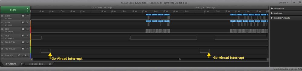

You did not show us the signal which is the "go-ahead interrupt". My crystal cube says, that the problem is in that in the second phase of communication the master starts to clock before the interrupt routine stores the first byte into SPI_DR (and the issue is marginal). You probably first send from slave to master the ""go-ahead interrupt"" signal, then call HAL_SPI_Receive_IT(), don't you.

This is a failed transfer go-ahead interrupt showing. The idea behind that interrupt was to prevent the master from starting the transfer before the slave is ready. The go-ahead (rising edge) interrupt goes out, then /ACS goes active, then the clocks start.
This image has one more change - I reset the SPI between the first transfer and the second. Now instead of getting the extra 0x14, I get an extra 0x00. Resetting the SPI would make sure that there is nothing in the TX buffer. I also removed the SPI_NSS_PULSE_DISABLE from the Slave TX Side which is why all of the clock pulses are now together.

I know it's been almost 2 years since this thread began but I ran into this as well and, based on JW's idea, was able to fix it by adding a slight delay between my request for data and pulling it out of the slave. In other words, I gave my STM32 time to execute the HAL_SPI_TransmitReceive_IT function before starting the SPI clock om my MASTER.
