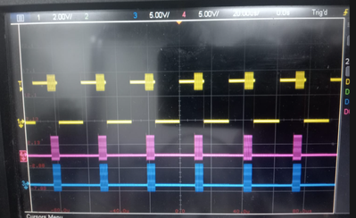

Hi @lobna  thanks
is SPI+DMA circular mode using LL library is available.
and I have a doubt, as of now I'm doing SPI+DMA in normal mode, and using two SPI, i want to run both the SPI parallelly. so after every transfer im clearing the flag and reenabling again for spi transfer in normal. this process is taking alomst 9 to 10us, how to reduce this process. so im starting SPI transfer at every 100us with tim7 interrupt.
you can see the image yellow is start of spi , blue and pink is two spi clocks, both the spi almost start at same time with some ns delay.
so you can see in the image after calling activate spi function to SPI clock starting it is taking almost 10us, below i have attached the code for activate spi. so how to reduce this start time in normal mode
below i have attached the code, so to reduce the time to 2us,
in spi circular mode overall it is 7.7us , including the SPI transfer complete callback.
actually in the below code circular mode configuration are enabled and normal are disabled

 LL_DMA_GetDataTransferDirection(DMA2, LL_DMA_STREAM_2));
 LL_DMA_SetDataLength(DMA2, LL_DMA_STREAM_2, ADS_DATA_SIZE);
 LL_DMA_SetPeriphRequest(DMA2, LL_DMA_STREAM_2, LL_DMAMUX1_REQ_SPI3_RX);
/* Enable DMA interrupts complete/error */
 LL_DMA_EnableIT_TC(DMA2, LL_DMA_STREAM_2);
 LL_DMA_EnableIT_TE(DMA2, LL_DMA_STREAM_2);
// LL_DMA_EnableIT_TC(DMA2, LL_DMA_STREAM_1);
// LL_DMA_EnableIT_TE(DMA2, LL_DMA_STREAM_1);
/* Initialize FFIFO Threshold */
/* Configure SPI1 DMA transfer interrupts */
/* Enable DMA TX Interrupt */
 LL_SPI_EnableDMAReq_TX(SPI3);
/* Enable DMA RX Interrupt */
 LL_SPI_EnableDMAReq_RX(SPI3);
 LL_DMA_EnableStream(DMA2, LL_DMA_STREAM_2); // RX
 LL_DMA_EnableStream(DMA2, LL_DMA_STREAM_3); // TX
void Activate_SPI(void)
// /* Disable SPI */
// LL_SPI_Disable(SPI2);
// LL_SPI_Disable(SPI3);
// /* Disable DMA */
// LL_DMA_DisableStream(DMA2, LL_DMA_STREAM_0); // RX
// LL_DMA_DisableStream(DMA2, LL_DMA_STREAM_1); // TX
// LL_DMA_DisableStream(DMA2, LL_DMA_STREAM_2); // RX
// LL_DMA_DisableStream(DMA2, LL_DMA_STREAM_3); // TX
// /* WAIT for DMA disable (CRITICAL on H7) */
// while (LL_DMA_IsEnabledStream(DMA2, LL_DMA_STREAM_0))
// __NOP();
// while (LL_DMA_IsEnabledStream(DMA2, LL_DMA_STREAM_1))
// __NOP();
// while (LL_DMA_IsEnabledStream(DMA2, LL_DMA_STREAM_2))
// __NOP();
// while (LL_DMA_IsEnabledStream(DMA2, LL_DMA_STREAM_3))
// __NOP();
// /* Clear DMA flags */
// LL_DMA_ClearFlag_TC0(DMA2);
// LL_DMA_ClearFlag_TE0(DMA2);
// LL_DMA_ClearFlag_TC1(DMA2);
// LL_DMA_ClearFlag_TE1(DMA2);
// LL_DMA_ClearFlag_TC2(DMA2);
// LL_DMA_ClearFlag_TE2(DMA2);
// LL_DMA_ClearFlag_TC3(DMA2);
// LL_DMA_ClearFlag_TE3(DMA2);
// /* Clear DMAMUX overrun */
// LL_DMAMUX_ClearFlag_SO15(DMAMUX1);
// /* Reload NDTR */
// LL_DMA_SetDataLength(DMA2, LL_DMA_STREAM_0, ADS_DATA_SIZE);
// LL_DMA_SetDataLength(DMA2, LL_DMA_STREAM_1, ADS_DATA_SIZE);
// LL_DMA_SetDataLength(DMA2, LL_DMA_STREAM_2, ADS_DATA_SIZE);
// LL_DMA_SetDataLength(DMA2, LL_DMA_STREAM_3, ADS_DATA_SIZE);
// /* Enable DMA streams */
// LL_DMA_EnableStream(DMA2, LL_DMA_STREAM_0);
// LL_DMA_EnableStream(DMA2, LL_DMA_STREAM_1);
// LL_DMA_EnableStream(DMA2, LL_DMA_STREAM_2);
// LL_DMA_EnableStream(DMA2, LL_DMA_STREAM_3);
// /* Enable SPI DMA requests */
// LL_SPI_EnableDMAReq_RX(SPI2);
// LL_SPI_EnableDMAReq_TX(SPI2);
// LL_SPI_EnableDMAReq_RX(SPI3);
// LL_SPI_EnableDMAReq_TX(SPI3);
// /* Enable SPI */
// LL_SPI_Enable(SPI2);
// LL_SPI_Enable(SPI3);
// /* Start transfer */
// LL_SPI_StartMasterTransfer(SPI2);
// LL_SPI_StartMasterTransfer(SPI3);
// CIRCULAR MODE//
// /* Enable SPI DMA requests (safe every time) */
/* Enable SPI */
/* Start clocking */

Dear @Srinath_03
Here are some suggestions to improve the execution time:
1- In your DMA IRQ handlers (e.g., DMA2_Stream0_IRQHandler), you disable the SPI peripheral (e.g., LL_SPI_Disable(SPI2)), which is not recommended in circular mode because it introduces delays and stops the communication.
Suggestion: Do not disable SPI inside the DMA callbacks; instead, let SPI and DMA run continuously. The same applies to SPI3 in DMA2_Stream2_IRQHandler.
2- Minimize the code executed inside DMA interrupt callbacks to reduce latency. Use simple flags to indicate transfer completion without calling heavy or blocking functions.
3- Optimize buffer access by treating DMA RX buffers as read-only in the main loop or timer callback. In the timer callback, only read (e.g., using memcpy function) the DMA RX buffers (ADS_DATA_VOLT_RX, ADS_DATA_CURR_RX) into local buffers for further processing. Never write directly into the DMA RX buffers.
Process the copied data outside the interrupt context (e.g., in the main loop or a dedicated task).
Best regards,
Lobna

Hi @lobna Thanks,
with circular mode no problem, with respect to SPI speed of 25MHz for 16bytes taking almost 7. 7us. I'm asking for normal mode DMA, so in normal mode clearing the flags, data length and starting transfer again for both the spi parallelly, so this is taking almost 9us for starting of spi clock itself and finishing it is almost taking overall one complete transfer complete 15us.
so how to reduce this initial 9us starting, is there any other way to reduce this to 2us. the Activate_SPI function this calling in every 100us timer interrupt
so basically, in normal mode with LL library how to start the next transfer, with only less time,
below again I have attached the code for normal mode DMA

Dear @Srinath_03
Your current Activate_SPI() disables all DMA streams and waits for them to be fully disabled before restarting. This can be time consuming.
Another idea to consider, which can reduce time, is to use a state machine with timer-driven or interrupt-driven checks to asynchronously detect the completion of DMA disable.
BR
Lobna
