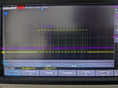

I've been having this problem where I configure my STM32F303VCT6 to send out 8 bits but the CLK sends out 16 cycles. I already tried casting the data as proposed on other forum posts but it doesn't work for me. Does anyone see the problem?

- - - Oscilloscope - - -
Change
uint32_t *SPIx_DR = (uint32_t*)0x4001300C;
to
volatile uint8_t* SPIx_DR = (volatile uint8_t*) 0x4001300C;
3 REPLIES 3
Write DR with byte width not word
I'm sorry I'm pretty new to programming so I don't understand what you're saying.
What should I change in my code?
Change
to
