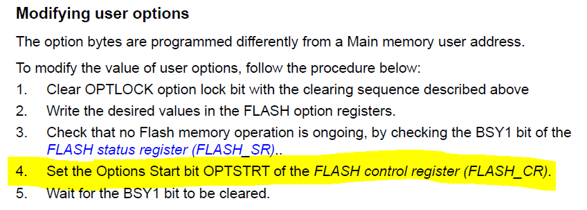

Option bytes need loaded by setting OPTSTRT. Not sure if you can set this via the UART bootloader, but it's worth trying.

I have tried to configure the Option bytes via software on the stm32g071which implement the same sequence you have mentioned :
Code:
// unlock flash
if (HAL_FLASH_Unlock() == HAL_OK) {
// unlock option bytes in particular
if (HAL_FLASH_OB_Unlock() == HAL_OK) {
// program selected option byte
HAL_FLASHEx_OBProgram(&OBInit); // result not checked as there is no recourse at this point
if (HAL_FLASH_OB_Lock() == HAL_OK) {
HAL_FLASH_Lock(); // again, no recourse
HAL_FLASH_OB_Launch(); // reset occurs here (sorry, debugger)
But actually, this produces the same result, I have to power cycle the board to get the new option bytes implemented.

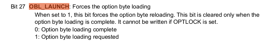

and I found a small note regarding the FLASH control register (FLASH_CR) bit 27 OBL_LANCH:
which is executed by HAL_FLASH_OB_Launch(); to force the option byte loading, that it cannot be written if OPTLOCK is set,
but if you reverse the sequence in your code to call HAL_FLASH_OB_Launch(); function while you unlocking the option bytes, it will generate a reset and prevent you from lock the option bytes again, which will break the board, and you will not able to communicate to your MC any more with anyway and it will not run the software either.
So any suggestions to revive the dead board or implement the Option bytes without power cycle?
