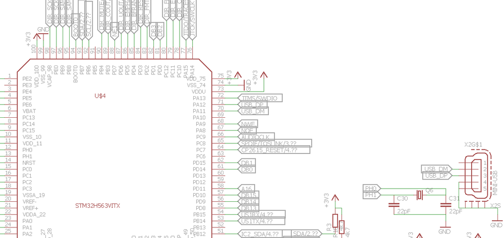

I'm creating a custom board using a used STM32H563VIT. Nice processor, but I can't understand how to create an Audo class, even if it's BT 1.0.
In the F series of processors, e.g. STM32F720, it was simple, but here it is somehow mixed up.
USB parts diagram:

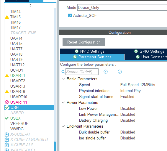

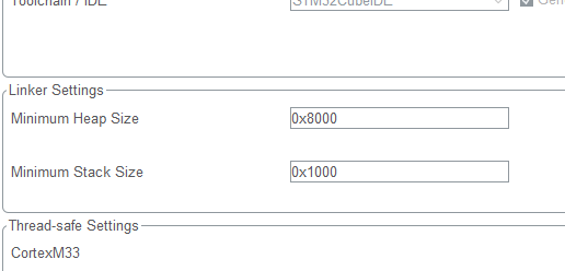

I have configured the USB
I configured USBX as FS_Device

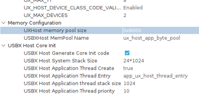

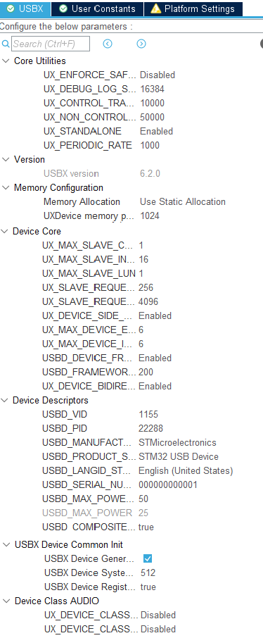

I took the stack size
After my changes

‎2024-05-13 12:45 AM - edited ‎2024-05-13 12:46 AM
i made Audio host , with Azure/threadx, so its not same, but :
- i needed a lot more memory, to get it work -> so try more memory
Try enabled ... if not sure, that disabled is, what you want.

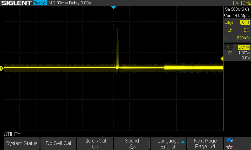

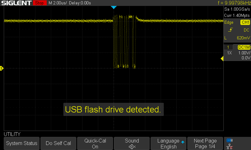

I checked with an oscilloscope, no signal on DP.
I only see power disturbances
After soldering the 1K5 resistor to +3.3V, the system recognizes the device, but does not recognize it.
Now I have
The descriptor request failed
So its not powered or started .
