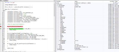

I'm using a SMT32H562ZGT6 uC with RTC pheripheral enabled and clock source from LSE. But HAL_RTC_Init() function returns HAL_TIMEOUT. Investigating I found the method RTC_EnterInitMode returns HAL_TIMEOUT.
Clock configuration is performed before calling the RTC initiazlization using The SystemClock_Config generated by cubeMX:

After that I'm initializing the RTC as follows:
bool RTC_C::initialize()
 _RTCHandler.Instance = RTC;
 _RTCHandler.Init.HourFormat = RTC_HOURFORMAT_24;
 _RTCHandler.Init.AsynchPrediv = 127;
 _RTCHandler.Init.SynchPrediv = 255;
 _RTCHandler.Init.OutPut = RTC_OUTPUT_DISABLE;
 _RTCHandler.Init.OutPutRemap = RTC_OUTPUT_REMAP_NONE;
 _RTCHandler.Init.OutPutPolarity = RTC_OUTPUT_POLARITY_HIGH;
 _RTCHandler.Init.OutPutType = RTC_OUTPUT_TYPE_OPENDRAIN;
 _RTCHandler.Init.OutPutPullUp = RTC_OUTPUT_PULLUP_NONE;
 _RTCHandler.Init.BinMode = RTC_BINARY_NONE;
 if (HAL_RTC_Init(&_RTCHandler) != HAL_OK) {
 return false;
 RTC_PrivilegeStateTypeDef privilegeState = {0};
 privilegeState.rtcPrivilegeFull = RTC_PRIVILEGE_FULL_NO;
 privilegeState.backupRegisterPrivZone = RTC_PRIVILEGE_BKUP_ZONE_NONE;
 privilegeState.backupRegisterStartZone2 = RTC_BKP_DR0;
 privilegeState.backupRegisterStartZone3 = RTC_BKP_DR0;
 if (HAL_RTCEx_PrivilegeModeSet(&_RTCHandler, &privilegeState) != HAL_OK) {
 return false;
 if (HAL_OK != HAL_RTC_WaitForSynchro(&_RTCHandler)) {
 return false;
 return true;
But initialization fails.
Can someone give me some hints? or have alredy experienced a similar issue?
Thank you in advance for the support.
MattiaB

This is the value of RCC_BDCR:
I've not used ST examples yet, but seems I've found something...
When HAL_RTC_Init() is called the following check is performed:
if (hrtc->State == HAL_RTC_STATE_RESET)
 /* Allocate lock resource and initialize it */
 hrtc->Lock = HAL_UNLOCKED;
 /* Initialize RTC MSP */
 HAL_RTC_MspInit(hrtc);
But initially the state is not  HAL_RTC_STATE_RESET and HAL_RTC_MspInit() is not performed.
Calling HAL_RTC_MspInit() before the HAL_RTC_Init() the RTC_EnterInitMode() function doesn't return HAL_TIMEOUT anymore:
 HAL_RTC_MspInit(&_RTCHandler);
 return false;
 return false;
 return false;
 return true;
I don't know if this can be considered a fix or a workaround.

Can you check the status of the RCC_BDCR register when this issue happens ?
Also, have you tried any of the STM32CubeMX RTC examples ? it could be useful to test if these basic examples work to eliminate the possibility that you have a hardware problem.

Hello @MattiaB
What is the handle state before executing HAL_RTC_Init(). Is the first init of the RTC peripheral?
