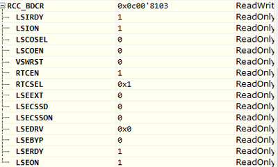

This is the value of RCC_BDCR:

Jojo_
Can you check the status of the RCC_BDCR register when this issue happens ?
Also, have you tried any of the STM32CubeMX RTC examples ? it could be useful to test if these basic examples work to eliminate the possibility that you have a hardware problem.
