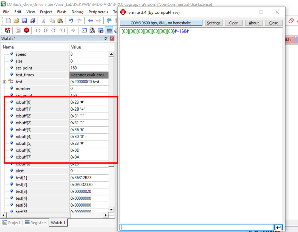

I wonder when I transmit the wrong data package from peripheral to memory, as the wrong size as I configured, where the offset pointer locates that the location for the next transmission is not at the start of the memory (memory 0 since I using direct mode), it starts as arbitrary locations within the range of memory location I configured.
How to return to the start of memory 0?
Thank you,
Have a good day.
At beginning of the program, the first of my data stored correctly in rxbuff[0]
However, when I transmitted the wrong size of the data package, the next time the first byte doesn't store at rxbuff[0].

Sure. Here is my related code
int8_t rxbuff[8];

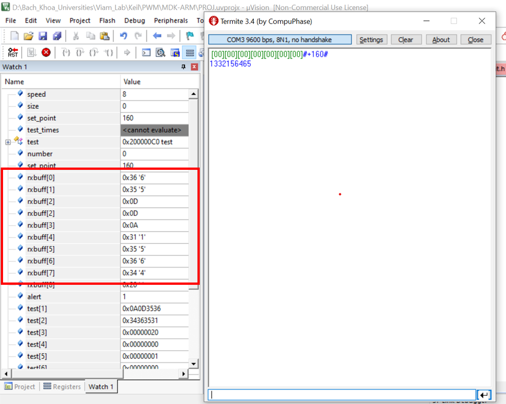

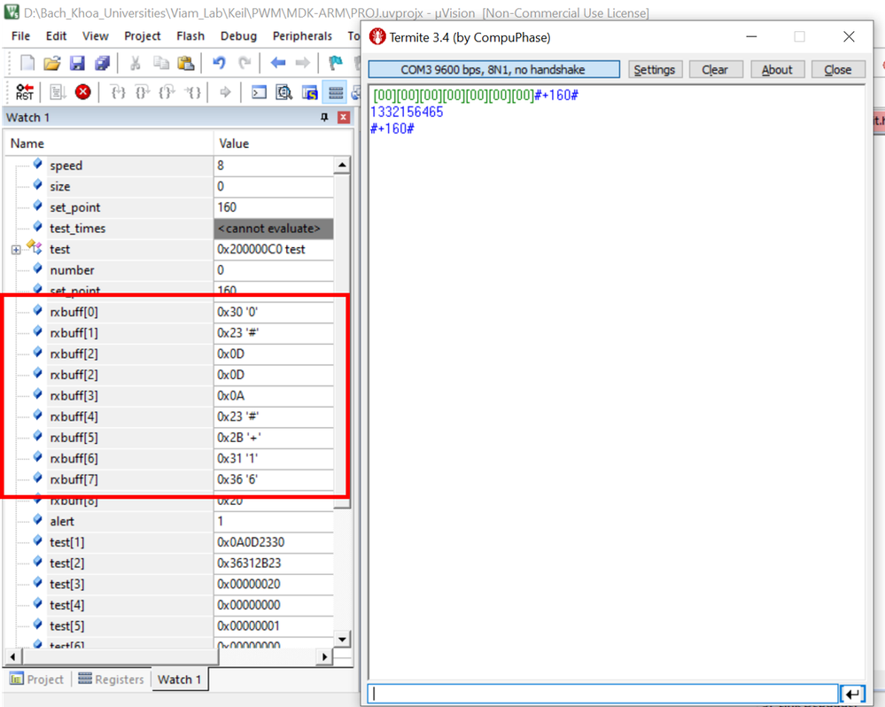

I mean that I am ok with the transmission, however, I don't know how the way that when my code pack bounded by the wrong character, the next transmission, will store the newly received byte at rxbuff[0].
In my case, with the wrong data pack's size (wrong bounded character), the next new byte will be stored somewhere of the rxbuff (as the 2nd and 3rd picture ), not the first location of rxbuff.
Please help me figure it.
‎2021-02-04 9:31 AM
You appear to have packets terminated by 0D/0A. So, in case of "synchronization loss", you might wait until those characters, and then start the packet reception again.
