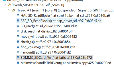

I have been trying to read/write into an SD card using the SPI or SDMMC method with Fatfs. I wasn't able to make use of the filex option for file operation which is provided in the STM32u5A9 libraries, since I am using FreeRTOS in my project (as per notes, Filex cannot be used with FreeRTOS). So, I have taken the FatFs library from STM32F4 design and ported the same to STM32U5A9 design (took reference from https://deepbluembedded.com/stm32-sd-card-spi-fatfs-tutorial-examples/). Unfortunately, in both SPI and SDMMC methods, I was not able to initialize my SD card and the application keep on waiting for SPI Rx data in SPI mode, and in SDMMC method, the application keeps on waiting in a HAL_Delay() in HAL_SD_initcard() API

1. I have more than 3 tasks running to execute different implementation. Major tasks in my application are UART task (having 30ms cycle time - osPriorityHigh), TouchGfx task (to update the received UART data in the display - osPriorityRealtime) and an SD card task (periodically update the device status every 5 seconds - osPriorityRealtime1)
2. With the above tasks priorities the application runs seamlessly for 40+ minutes and after that, the SD card task halts in the same API as before HAL_SD_ReadBlocks()
The application doesnt write data or show the updated UART data in screen, since the SD card task takes over the priority, and never returns. What should I do in this case? Can you please shed some light on this?

I reduced the SD_TIMEOUT from SD_DATATIMEOUT(0xFFFFFFFF) to 30000 and tried to run the app. The application ran for about 50 minutes and I got the FR_DISK_ERR in the f_mount() API.
