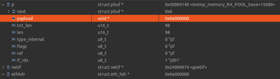

When debugging, I noticed that `p` buffer is valid, however, the payload is invalid.
Details:0x30004140 <memp_memory_RX_POOL_base+15680>
Default:0x30004140 <memp_memory_RX_POOL_base+15680>
Decimal:805323072
Hex:0x30004140
Binary:110000000000000100000101000000
Octal:06000040500
Details:0x9a000000
Default:0x9a000000
Decimal:-1711276032
Hex:0x9a000000
Binary:10011010000000000000000000000000
Octal:023200000000

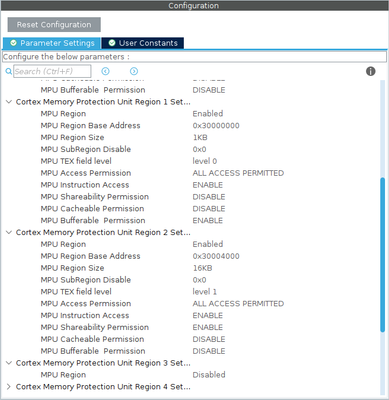

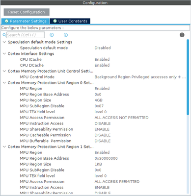

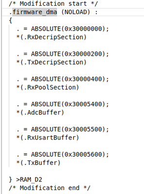

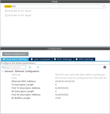

Configuration
I have a STM32H723ZG. This is how things are configured.
## MPU
ETH
LWIP
STM32H723ZGTX_FLASH.ld

@eduardo_reis wrote:When debugging, I noticed that `p` buffer is valid, however, the payload is invalid.
Are you passing auto data, so that the data is no longer valid by the time LwIP tries to access it?
That's a different problem: In @LEAMtw's case, the pointer was invalid, and accessing the invalid memory caused a Hard Fault.
Also, that case was using FreeRTOS - which you're not.

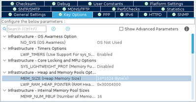

- Increase stack size
- Enable diagnostics
By stack size you mean LWIP MEM_SIZE? What should I estimate when defining the stack size?I have it as 14 KB, which to seems to be way above my needs.
