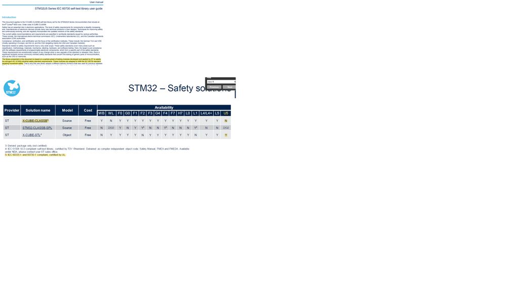

Hello Support Team,
Have a wonderful day.
We are selected Trustzone MCU STM32U585ZIT6Q for our product we have some queries regarding the certification
Based on the attached user guide snapshot, we could understand this U5 series chip have a Class B library that supports IEC 61518 and was adopted to fulfil the IEC60730 requirement.
Is that ok to proceed with UL1998/IEC60730 certification by integrating the ClassB STL library for the U5 series?
Also, could you share the latest UL-compliant certificate for the STM32 U5 series?
Thanks
