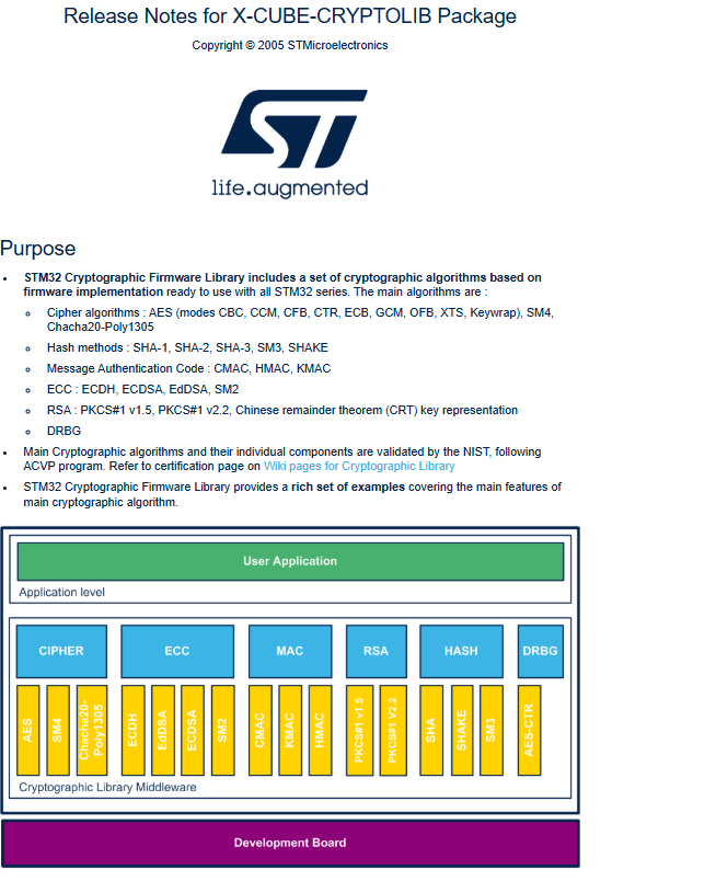

After checking the current release note for XCUBE_CRYPTOLIB(v4.6), i couldnt find ML_DSA as well, in this case i Should wait for the latest package to be released right? Attaching available packages for current cryptolib
Release note CRYPTOLIBRelease note CRYPTOLIB
Thanks again for your support
Best Regards
Philip

Jocelyn RICARD
I can confirm the new cryptolib V5 will support PQC : ML-KEM, ML-DSA, LMS and XMSS with examples for all targets supported in cryptolib V4
One important update: CRC dependency has been removed
Apparently there is still some delay, possibly 2 weeks more, for official delivery due to paper work (The libraries for each Cortex-M and examples are ready since one month ...)
