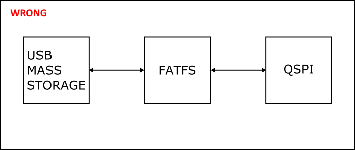

‎2018-03-22 10:47 PM
Thank you for answer,
Ok now I think I get the idea... Please confirm either this is right or wrong. I thought the design for this would look like this:

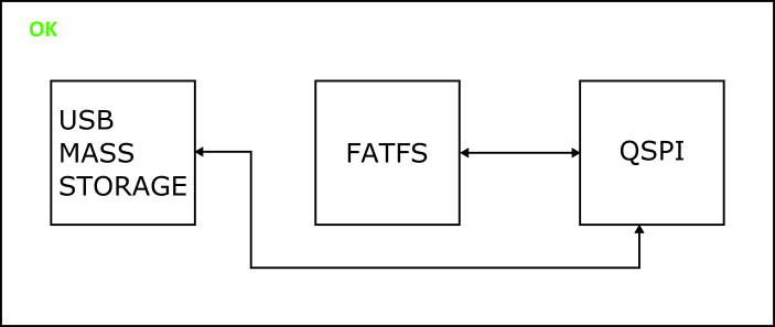

Where as it has to work like this:
The USB mass storage cannot use the FatFs file system, since it already has its own file system. The FatFs mapping has to be 100% covered with the maping done by the windows or linux computer connected through USB. Is that correct?

In the general sense the logic needs to equate too
AddressWithinQSPI = blkAddr * BLK_SIZE;
LengthInBytes = noOfBlocks * BLK_SIZE;
AddressInSTM32 = 0x90000000 + AddressWithinQSPI ;
If you have it memory mapped, then memcpy() would be efficient, though might not play well with Erase/Write operations.
Don't think it is working with clusters, Blocks != Clusters (except for small media), Blocks = Sectors, fat_getClusterSize() is likely to get to be 8KB or 32KB, etc depending on size of media, and not appropriate here. Cluster management should be occurring deeper in FatFs, and noOfBlock likely peak at the cluster size.
The QSPI pages can be smaller than 512 bytes, often 256 bytes in devices I've seen. On write you'd need to pre-erase the pages you expect to write, and then write the new data.
‎2018-03-23 11:03 AM
Yes, and only one of these should have control otherwise you will get coherency issues and damage, as Windows will cache content and write with no regard to what FatFs might be doing.
