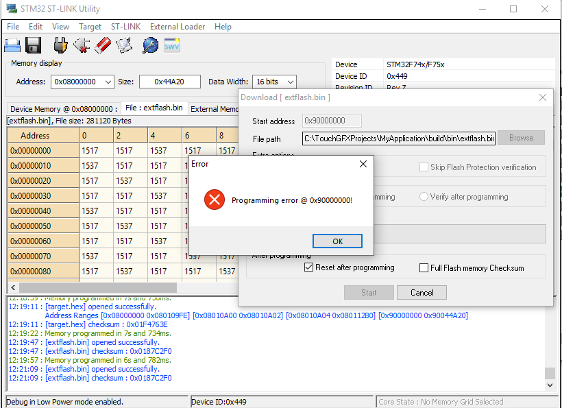

I have tried the external loader with your CLIVEONE-N25Q128A_STM32F7XX-CUSTOM stldr file in STM32f746g DISCOVERY Board
it didn't work,and i have attached the error image .
it will be better send the Loader_src file and Dev_Inf.c file,

AFAIK Clive Avogadro works with the Cube programmer rather than the STLink Utility. They both have their own set of idiosyncrasies.
Also, my experience was, that an actual program (using the sFLASH) being present in the mcu fought with the sFLASH loader. This might depend on various things (versions of all involved elements in the chain, reset and "attachment" settings, who knows) but to err on the safe side, you perhaps may want to start with an erased mcu.
