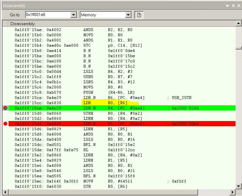

I have pinpointed where in the bootloader it goes wrong. The bootloader reads the USB_ISTR.
The value is 0x2000 on the faulty board and 0x0900 on the board that works.
It is the SUSP bit that is cleared on the faulty board. And I guess this makes the bootlaoder boot into DFU as it think there is something connected to the USB.

The problem is now fixed. We removed a 100kohm pulldown on PA12.

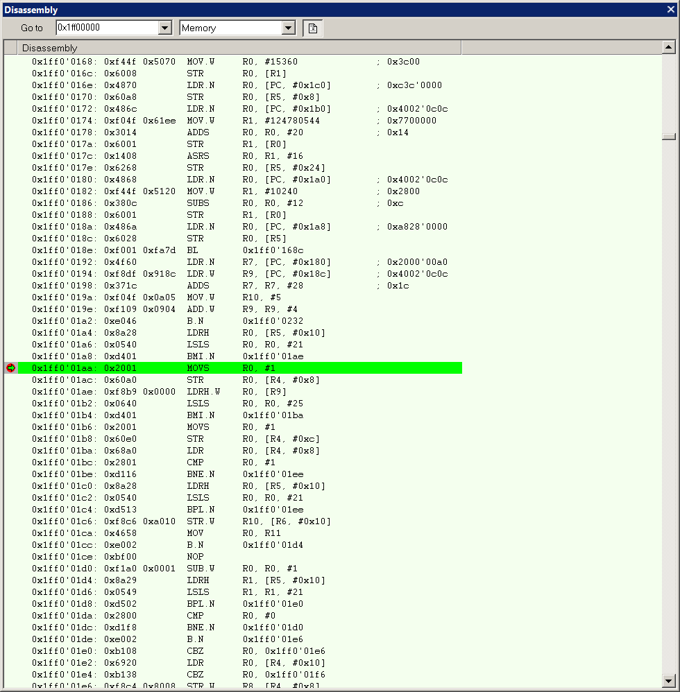

I tried on a working board and put a breakpoint at 0x1ff001aa where the bootloader has seen a zero on PA10. The run halts on this breakpoint when I send 0x7F to the MCU. All ok. But on a non working board I can't get it to halt at that breakpoint. I suspect that the boot loader has taken another path.
You could pause the "non-working" chip to see where it's at. The bootloader is going to go to the first supported peripheral it sees.
You're also mixing up USART1 and USART2, maybe the USART2 in your reply earlier was a typo.

And what is connected to the USB pins?
