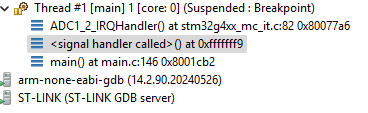

There is one signal handler called as shown above i am not sure what it is? I have been struggling to understand, please help.

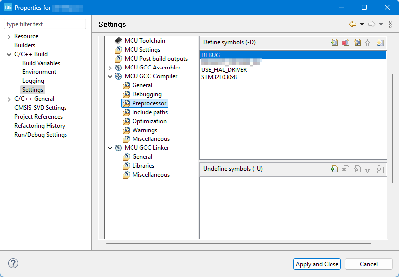

Yes HAL is same , but no only ld require change. If you use Cube IDE check and change build defines etc.
Can you please tell me where the build defines will be in which files. I have generated the code using MCSDK 6.4.0 and then manually edited the files

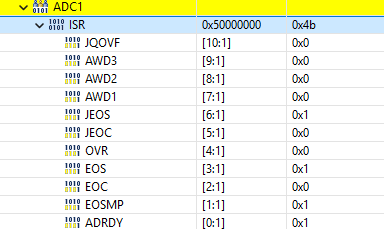

Set a breakpoint at ADC1_2_IRQHandler and check the flags of ADC1, ADC2 to see why it's being called.

I can see the JEOS and EOS flag is set.
below message i am seeing when i click on the error.
fffffff9: Failed to execute MI command:
-data-disassemble -s 4294967289 -e 4294967322 -- 3
Error message from debugger back end:
Cannot access memory at address 0xfffffff8
Sorry , but you try drive Porshe without driver license... Signal handler in debug only mark , that hw invoke ISR.
Click on it get nothing + error.

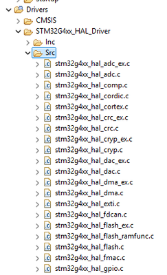

I copied all the HAL drivers in the folder Drivers\STM32G4xx_HAL_Driver\Src from the reference folder, the interrupt does not happen now. Can you explain me please i am really not able to understand i tried to optimize by removing some of the src files in the HAL folder, then this issue happened, if the src files are required why i did not get compilation error. It is really confusing.
There are huge number of .c files in the folder
more than this, i did not require them, what is the issue is it the root cause?
Hello @STuser2
Could you specify which files you removed?
In the Project Properties:
