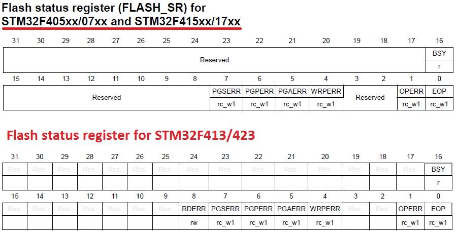

I'm trying to port a library written for STM32F413 to another device of the family, the STM32F407. The library depends heavily on the Flash HAL module driver, which I have never used before in any of my projects.
The driver for the STM32F413 has a lot more definitions from those defined in the STM32F407 driver, mainly those associated with the Status Register.
This is from the STM32F413 driver:

This is from the STM32F407 driver:

As you can see in the following image, the RDERR bit is only available for STM32F413.
I will try to comment out code that reads that bit, but what else might go wrong? I mean is there anything I have missed here that should be modified before I can use the driver on my target device?

Hi Zaher.
""I will try to comment out code that reads that bit, but what else might go wrong?"
It sounds like "i will try to cut the yellow wire of the bomb":)
Commenting out code stops build errors but usually causes run-time errors..
In all cases must examine the code that uses this bit and change it appropriately.
I recommend to change the code that reads this bit, to return always zero and code that writes to this bit, to dummy write code.
Hi Vangelis,
Yep, returning zero sounds a good idea, and by the way, I'm still debugging the application so in terms of the metaphor you have used, I'm ready to deal with any explosion, though it's not quite a bomb! :D
Zaher
