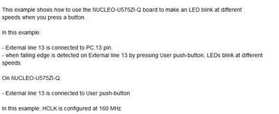

Pour commencer j'ai d'abord réalisé un bout de code pour faire clignoter une led (LED_GREEN); à une certaine fréquence réglée par HAL_Delay.
Le souci est que cette fonction bloque car le Tick ne semble pas être validé, (HAL_GetTick  me retourne toujours 0)...

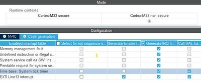

Je crois pourtant avoir validé les interruptions :

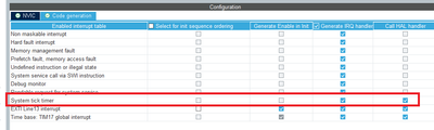

Check if the option to generate the system tick interrupt handler code is checked in the code generation tab:

 @mƎALLEm : Yes the option to generate the system tick interrupt handler code is checked in the code generation tab:

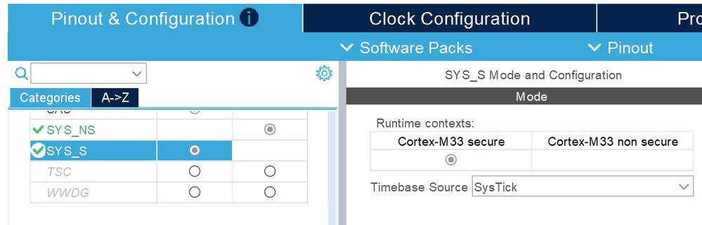

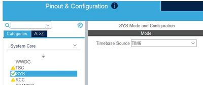

What do you have selected as the Timebase Source in the CubeMX project?
On what physical hardware are you running your code?
Thank you for your proposal. !

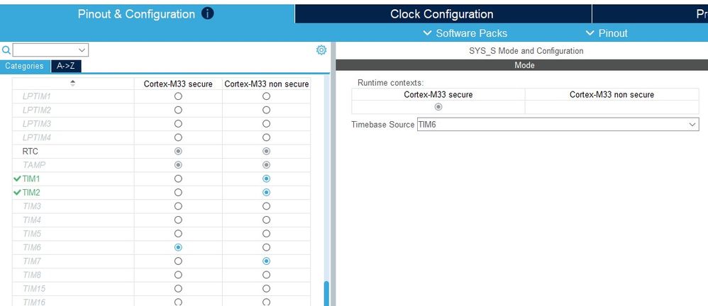

No I can't select TIM1, SysTick is the only possibility, all other proposals are grayed out...
The code runs on the physical hardware NUCLEO-U575ZI-Q, I am currently creating a prototype with an SPI display and a Quad SPI flash that will interface with the Nucleo board via the expansion connectors.
I haven't used the secure code features of the U5 series but you can see the HAL_IncTick() being called from the SysTick_Handler() in both ./Secure/Core/Src/stm32u5xx_it.c: and ./NonSecure/Core/Src/stm32u5xx_it.c
You have the Timebase source set as SysTick so I would suggest either stepping through the code using the debugger or grepping through the source code on a terminal and figure out if SysTick is getting set up correctly.

I
I believe you need to select which domain each timer is in, secure or non-secure.  Then it will be available as a Timebase Source.  I haven't used any of the secure features yet so I can't give much more support.
