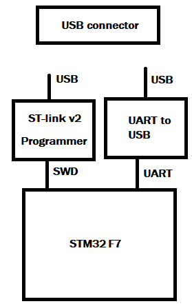

In Nucleo, Both ST-link and "UART to USB" integrated in same/single USB connector. If I use ST-LINK/V2 as external programmer device, then how to combine "UART to USB" and external ST-link programming cable's USB connectivity on the same USB connector interface?

It's not really difficult to combine multiple data streams on one USB port, as this is what USB was designed for. The STM32F103 at the ST-LINK/V2 just merges the SWD stream and the UART stream.
I do agree that we can manage entire solution by using STM32F103. But, this solution requires firmware development. I'm looking for solution without using firmware development

If both channels really need to be transmitted to the host, ST-LINK/V2-1 might be a good choice. It is part of almost all NUCLEO-64 and can be broken from the target board. It offers RXD/TXD for the UART channel and SWD for the debug channel. You will find an overview of the available NUCLEO here.
The only downside: it's just a board and comes without a case. There are also some guys who use this exact approach, e.g.
