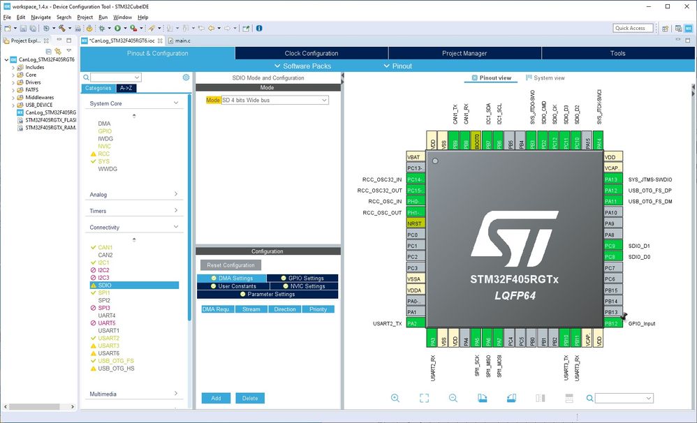

Yes, I forgot to mention one more piece of data: I also have USB_OTG_FS selected as "Device_Only".
(I updated my initial post to include USB_OTG_FS.)
If I deselect it, then my SDIO is OK with no yellow icon beside it.
Is it truly due to pin assignments or something else?
I first thought that it was because of pin assignments.
However, when selecting only USB_OTG_FS as "Device_Only", and disabling SDIO, only PA11 and PA12 pins are set.
When selecting only SDIO as "SD 4 bits Wide bus", and disabling USB_OTG_FS, the pins that are set are:
PC8, PC9, PC10, PC11, PC12, and PD2.
Therefore, it doesn't look like there are pin conflicts?
If I have SDIO selected with CAN, I2C, and UART, but without USB_OTG_FS, everything is fine.
When I add USB_OTG_FS, then the warning icon comes beside SDIO.
When I move my mouse over the caution icon, the tool-tip message appears with text as follows:
   Partly disabled conflict with:
   CAN1: Master Mode
But again, CAN is using different pins--PB8 and PB9.
The following is my screen shot:
Please assist.

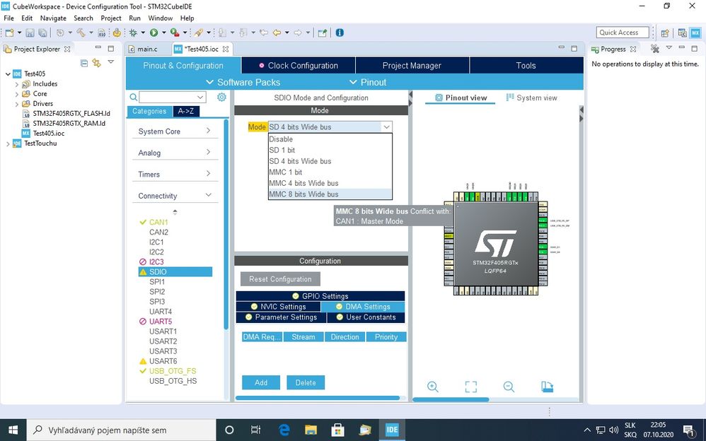

MM..1
Chief III
Warning is not problem only report that some function here SDIO is impossible,
for your config was in conflict MMC8bits mode SDIO
I'm not sure that I understand this response?
1. Is it possible to enable USB_OTG_FS, CAN and SDIO for this MCU?
(I’m assuming YES.)
2. What is this conflict? How can the conflict be mitigated?
3. What must I do to enable USB_OTG_FS, CAN and SDIO on this MCU?
4. Is there a good source of documentation for configuring USB_OTG_FS, CAN and SDIO?
Thanks
> 1. Is it possible to enable USB_OTG_FS, CAN and SDIO for this MCU? (I’m assuming YES.)
As of your last screen dump: yes
Yellow means that there are some configurations of SDIO which conflict. As @MM..1​  said and showed: if you drop down the list of possible SDIO configurations, some, but not all, are red. In this particular case only one SDIO config conflicts: SDIO using as MMIO with 8-bit wide data bus.
Mitigation: dont use SDIO in MMIO with 8-bit wide data bus mode (I think you never wanted that mode).
There is no conflict if you select SD 4 bits wide mode for example.
Screen dumps look okay, generated your C code from that.
For the tool in general: UM1718 User manual STM32CubeMX for STM32 configuration and initialization C code generation.
