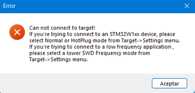

The problem I have in hands is as next. I was using Nucleo WB55 to use the STM32F103CBT6 to program a microcontroller I have in a custom PCB for an end product I'm designing. Until yesterday everything was working OK. Since yesterday the STM32CubeIDE is telling me that is not possible to connect with the programmer. I checked what's the message shown by this last program and it says:
Target no device found
Error in initializing ST-LINK device.
Reason: No device found on target.
 After seeing this, I downloaded the ST-Link Utility to connect to the board and the program says:
Now, having this message I proceeded to use the STM32CubeProgrammer to see what it can tell me and it shows:

2 REPLIES 2
STTwo-32
Hello @braian_bannert
Could you check that the jumper JP1 is set to USB STLINK and try to connect under Hot Plug mode. If you still can't connect, I suggest you try using another Nucleo-WB55. It may be that you have damaged your ST-LINK on one of your use cases.
Best Regards.
STTwo-32
GayathriMSG
Check the debug option in pinout configuration -> SYS -> debug. Check whether debug is in No debug or Serial wire or other options. Mine was in No debug that's why i got this error. Change it to Serial wire, and also check clock configurations according to your board.
